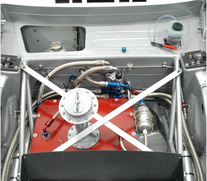

Kurt,
What is the purpose of the cross-straps in this photo? They don't seem to be big enough to be structural braces.
Attachment 19504
The braces are 1/4 inch thick aluminum and tightly clamp bolted but would not be much help in a wreck as the ends would fail. They are just added stiffness across the top of what was otherwise and open box. Kind of like a shoe box with no lid will deform easily but not so if you tape the lid on.
Required or not the right side net helps keep you in the safer angels zone in an offset hit. I jiggered my left side net system to do some of the same. Much of what a right side net does is guide you BACK into the seat after you deform and extend out of the seat past the side bolsters and head halo if present. that is why they must be tight to the seat sides. Too many that "pass" are too loose IMO and can be pushed out of place. This reduces the nets guide back and H&N system helping ability. I think your body would displace the net unless it is in right and tight during the impact and this adds complexity to the G forces. Complex G forces are very hard on you. Clean on/off G loads are surpassingly well tolerated but jagged whips and snaps much less so.
