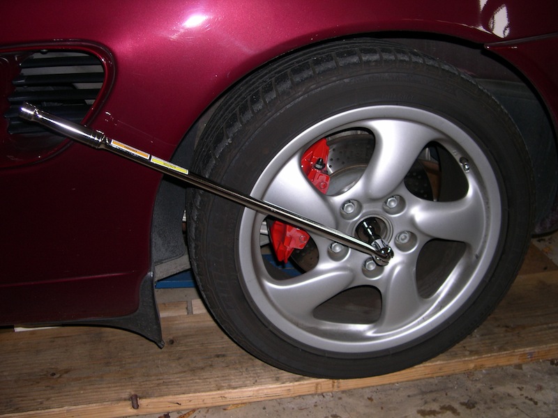

Remove axel nuts -- you need the half-shafts out to remove the tranny:

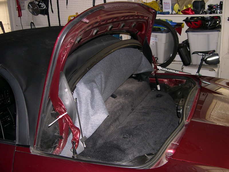

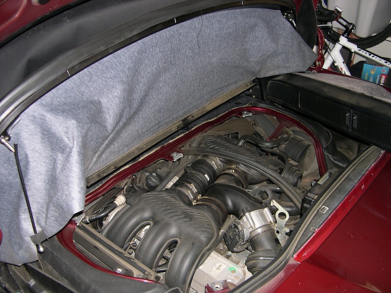

Remove storage tray/speakers, carpeted sound pad, and engine cover:

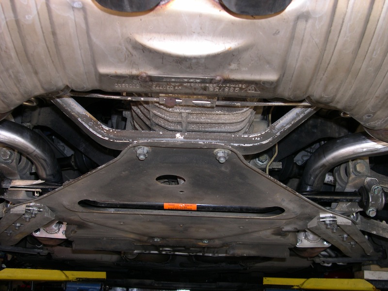

Raise car and begin working under the car -- at first it looks daunting with all of the exhaust parts and underbody bracing:

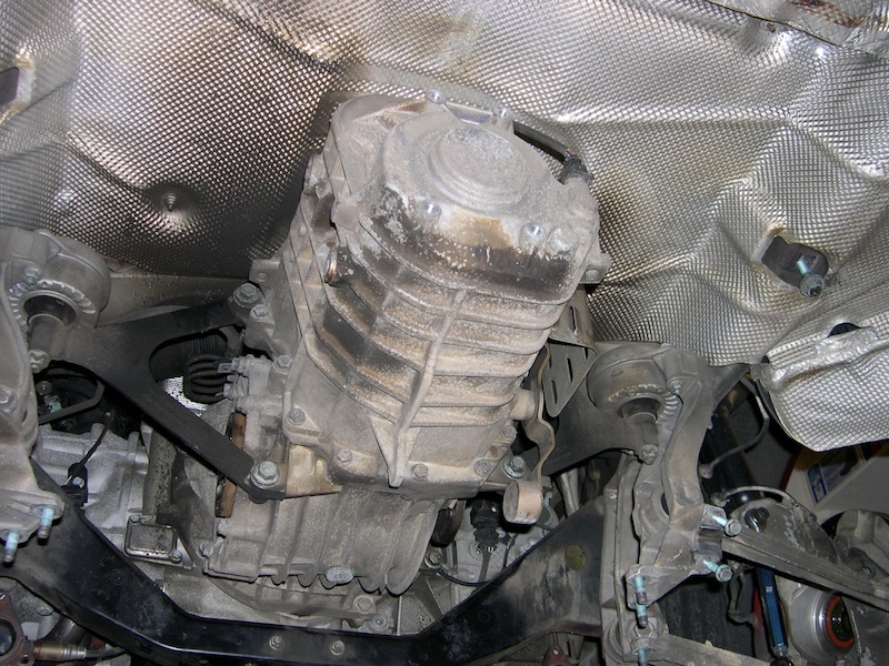

But once that stuff is out of the way, access to the tranny is excellent:

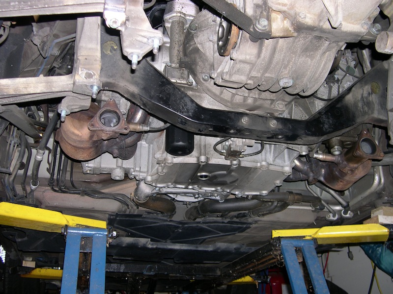

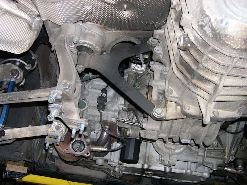

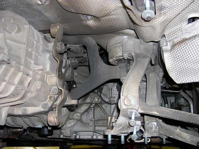

Here's another view, note the black cross brace that passes under the tranny bell housing. You can leave this in, but it is only 4 bolts (plus the crash tether bolt) and removing it gives even more room to work:

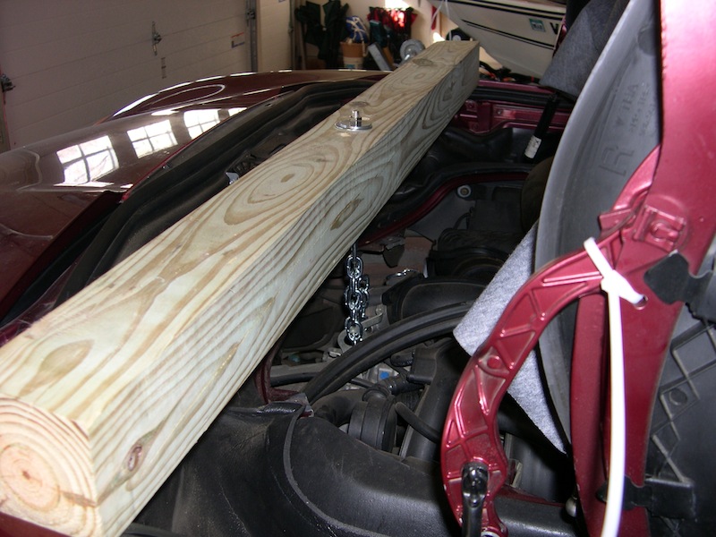

Before removing the tranny, you have to support the engine. Here is my $10 solution -- a 4x4, an eye bolt and a short chain:

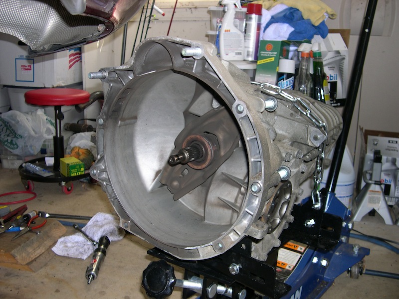

Disconnect reverse switch (at rear of tranny), shift cables (use a large flathead screwdriver to pop them off), and bell housing bolts. Then the tranny just slides out with plenty of room to spare.

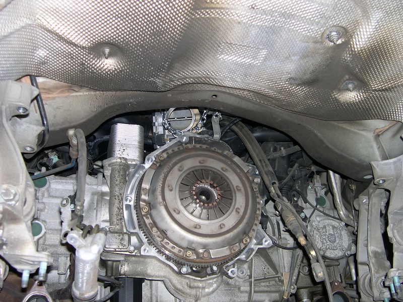

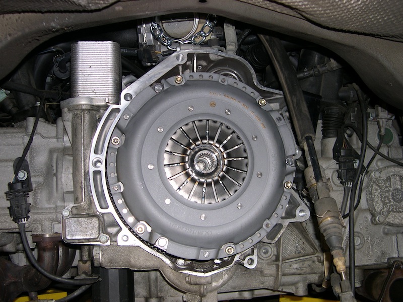

Old pressure plate, clutch, and flywheel.
New flywheel, clutch, and pressure plate. While my flywheel was OK, I decided to replace it anyway to ensure many more years of no worry driving.
Replace your throwout bearing, clean & lube the release pivot point, clean & lube splines on tranny input shaft, clean and lube the surface the throwout bearing slides on, then re-install tranny, half-shafts (don't forget to fully torque these after you have the car back on the ground), exhaust, underbody bracing, and go for a drive!
In my case, the new clutch is super smooth and progressive.
