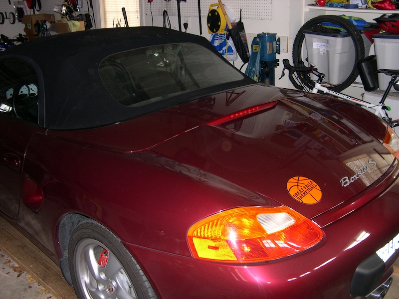

Here's the patient. 2000 Boxster S with 104K miles.
Attachment 22597
