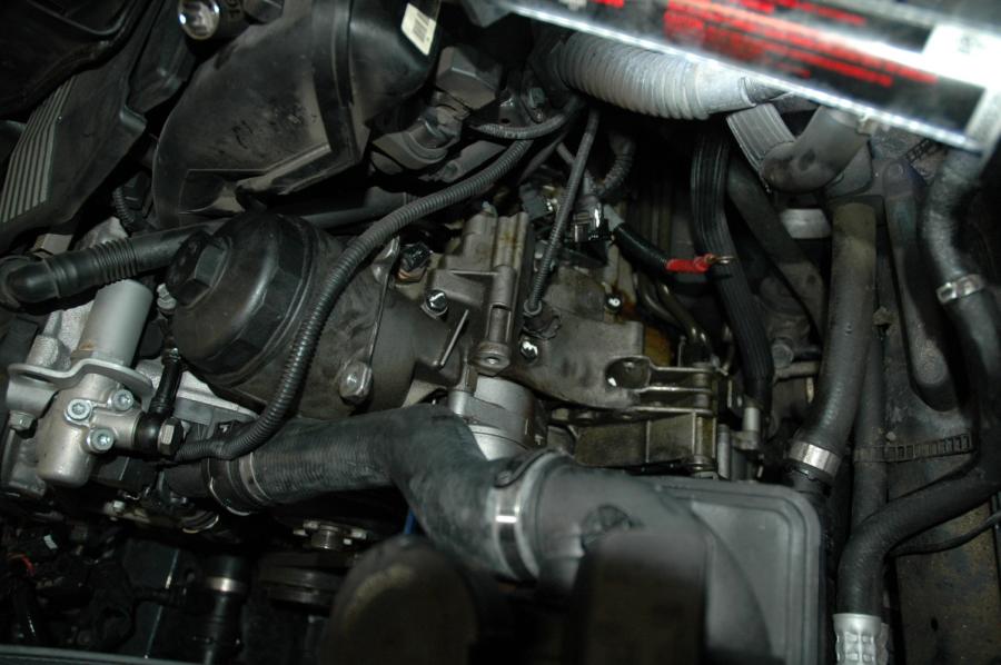

I was seeing a drip of oil in the garage which translated to the driveway now that the car is spending the winter outside for my 944 project. I thought it was the pan gasket, but Clarke tells me that the oil pan gasket leak is uncommon. An oil filter gasket leak will run down the slanted engine and look like it's coming from the passenger side.
If you remove the airbox, you can look at the (drivers) side of the engine and see the mess it makes. The gasket is $6 or so. Clarke (who is a professional mechanic at Manassas Motorwerkes) tell me that this is a job I can do in about 2 1/2 hours. The challenge is on! I started in the morning and was done in time for lunch.

Oily mess is to the left of the red alternator wire. Yes, I know it's hard to see.
