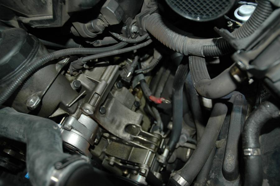

Oily mess is to the left of the red alternator wire. Yes, I know it's hard to see.

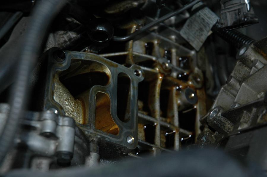

Here's the pics. First one showing the oily sludgy mess from the old leaky gasket. This one must have been leaking for quite a while to create such a mess. Second one is the two sensors and gasket, showing the part numbers. Third one is the bolts in order as they were removed. There's 3 different lengths. Bottom two are short, middle two are medium, and top two are 1 long 1 short. The short one on top is identical to the short ones on the bottom.
