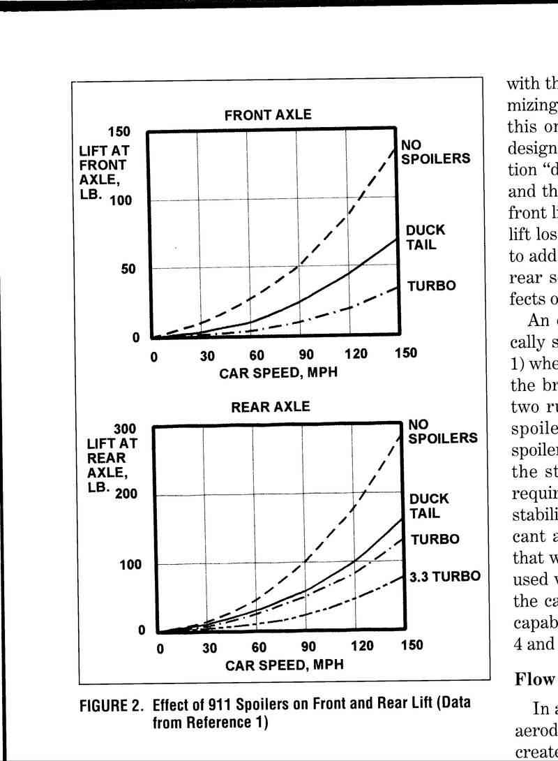

Some where in my files I have the original factory lift measurements....
Found 'em. These measured numbers make things crystal clear. What they show is that the effects follow the square of speed, which means that negligable lift is generated below 80MPH, and considerable lift is generated above 120MPH. What they do not show is the interaction between the front and rear spoilers. I have that chart somewhere, but you will have to take my word for it right now. - The chin spoiler by itself reduces lift front and rear, but not dramatically. - The rear spoiler by itself REALLY unbalances the car. Lift effects are considerably higher at the front axle. That said, I ran my 911 with a chin spoiler and no rear spoiler. I ran a very stiff torsion bar setup. The car was stable in high speed turns and on straights. It was not AS stable as a similar car with similar sulpension setup AND a rear wing. It was faster in terms of terminal speed that that car because of the drag penaly associated with the rear wing. FWIW, the only reason I didn't run the rear spoiler was becasu I preferred the lines of the 911 without it [unless we are talking wide bodies or serious race cars]. That one of the reasons I went to an all-business race car.

Tony: from Frere's book?
Do you think it is incorporating the various chin spoilers and / or no spoilers when contemplating those particular three rear wings? Jase |
Jase,
Yes, these are Paul Frere's charts. This set is rear wing only, and Frere used it to illustrate the impact that the rear wing had on both front and rear axle lift numbers. I have the other chart, but can't locate the scanned file right now. THat chart [and the text] talks to the interaction between front and rear spoilers, and highlights the non-intuitive finding that the rear spoiler only has a detrimental effect on front axle lift numbers - they go up considerably vs the no spoiler case.

Like TK I have some information on aero aides but can’t find it! From memory the “Duck” reduces lift. Whale, tea table, turbo, GT wings and others add down force. Now I wonder if the 993’s does down force or reduces?
