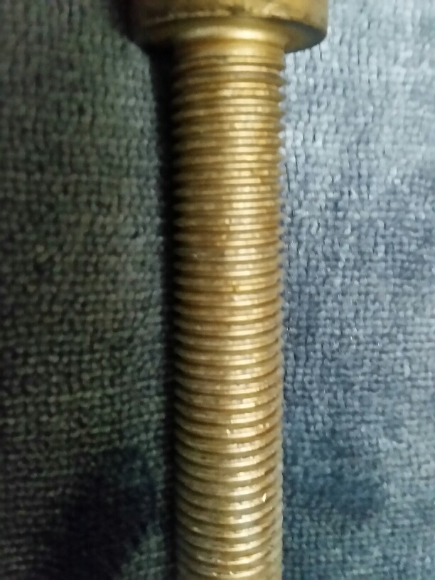

Anyone know what type of coating this is on the caliper bolt? It almost looks like brown-ish gold paint but it is not paint. Its not yellow zinc or cad either. I have seen a lot of different types of coatings over the years but haven't seen this before. After 47k miles, the bolts had nearly no corrosion on them and were easily removed without issue.
The new bolts from Porsche came in black oxide. I elected to go with SS studs from Tarret since I didn't like black oxide.
Steve

Maybe some sort of chromate. (which is over zinc IIRC?) You can get TONS of different shades of colors even by the same process. Its hard to rule out anything w/o a chemical analysis.

Its called cadmium II plating.

Thanks Matt. I now know what to ask when calling to check stock at dealers. I wish the replacement bolts provided would have had the same coating as the originals. I would have used them in a heartbeat in lieu of $125 for the studs.

Cadmium is real nasty stuff and is not used as often as in the past.

Update: I really wanted to stay with stock bolts and ended up contacting a dozen or so dealers. They all only had the black oxide bolts. However, the Tarret bits ended up being a nice upgrade.
