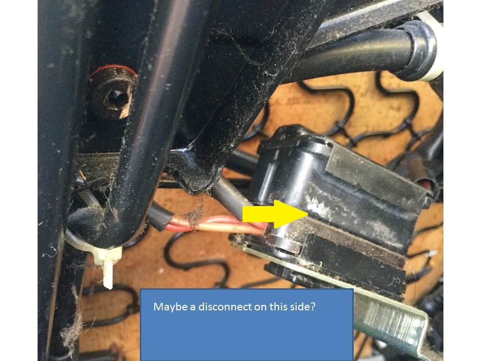

I was investigating what it would take to remove my seats today. The hardware was easy, but I couldn't figure out how/where to disconnect the wire coming from the car to the seat.
I figured out the the part leading towards your second photo...
I took off the backing plate.
I was hoping it disconnected from this somehow...
Opening it up left me stumped.
So it looks like the two parts of this black cube separate? And that's the disconnect point? That is a relief - it that's accurate. I am guessing it is a matter of grip carefully, wriggle/pull apart slowly?
Any advice is greatly appreciated!

Just use a flat screw driver and pry the 2 plugs apart, see below. But be careful one of the pins has continues power and the next to it is the ground.

Thank you, sir.
I disconnected the power when I started working, this was exactly the information I needed to continue.
What a breeze once I knew how to disconnect that wire! Thanks again!
