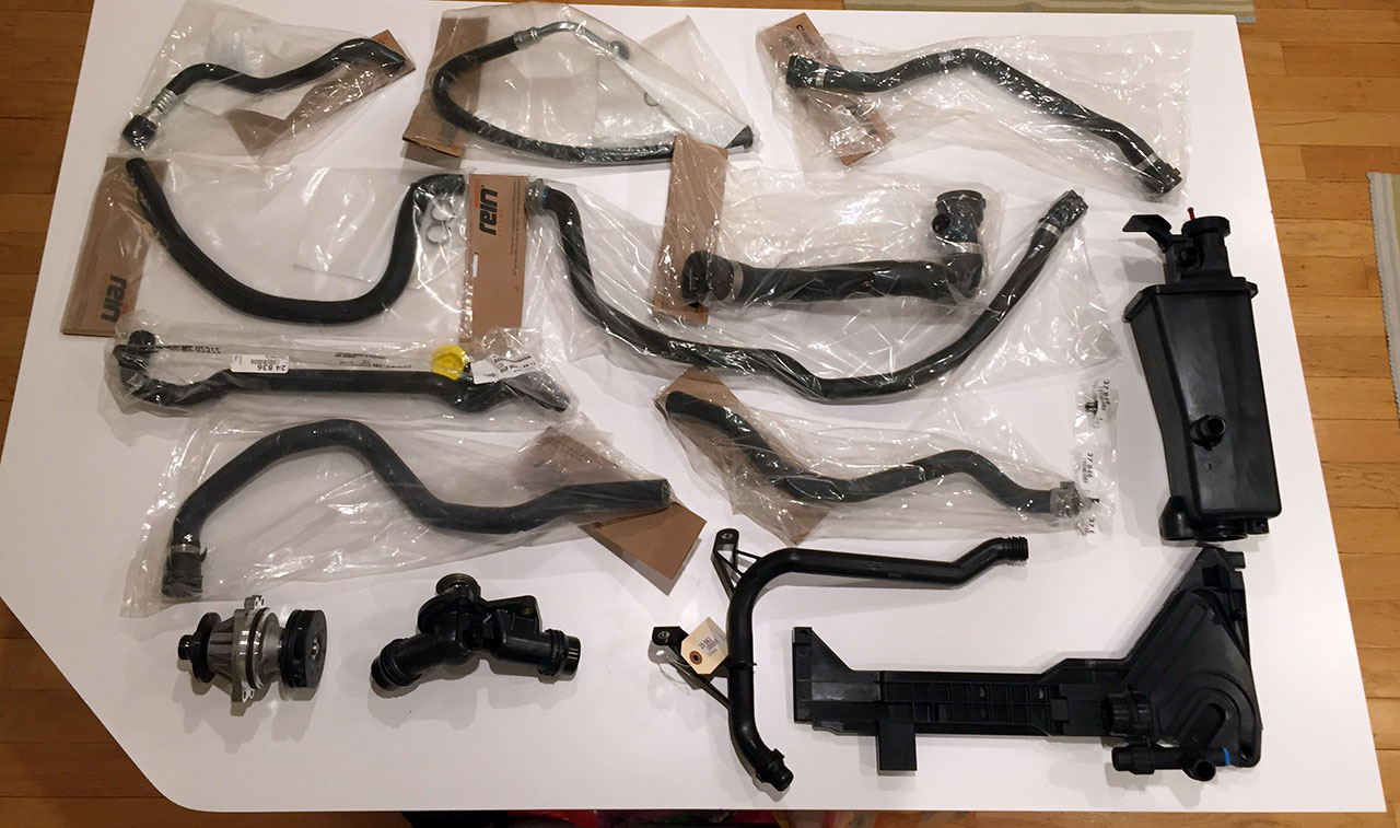

Me: "Hello. All the rubber hoses, gaskets, and o-rings under the hood of my E46 are falling apart"
BMW: "Yes, they do that. Which parts would you like to order?"
Me: "All of them"
BMW: "Done"
