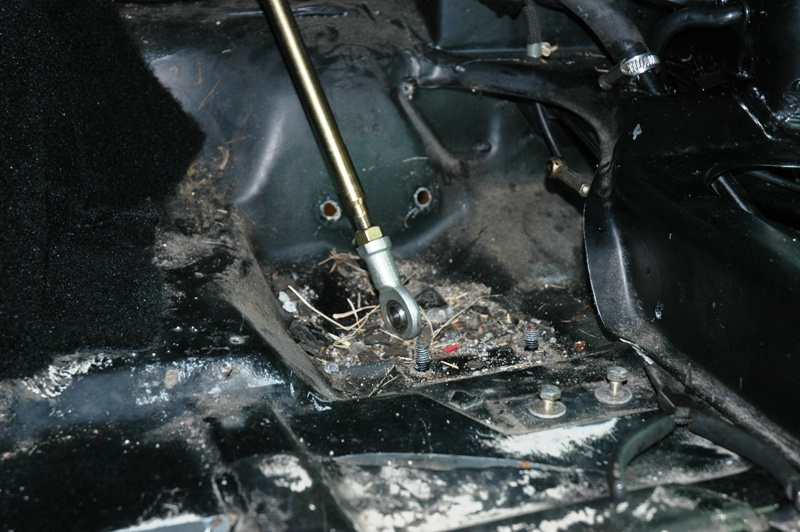

Last night I re-installed the master cylinder/brake booster. Not thinking, I bolted it down and torqued the nuts. Then realized that I needed some play in the booster to reattach the brake actuating rod. Dammit. Looking inside the car, I figured I could remove the pedal assy with about the same amount of trouble and accomplish the same task, so I went that route. While I had the pedal assy out, I looked at what it would take to rebuild. I've had a set of bronze pedal bushings laying around for about 2 years, never wanting the hassle of the rebuild because I heard it was a pain in the ass and mine was fine. Well, after getting the assy out, I found I was wrong on both counts. The original plastic bushings were noticeably worn, and its was extremely easy to rebuild.
Attachment 6017
It took all of 30mins from the start of pulling the pedals out until the cluster was rebuilt. Granted, I already had the floor board out and easy access to the bolts in the steering rack tunnel, so figure 1 hour if everything is in place. And, BTW, it's unbelievable how much crap there is under the pedals.
