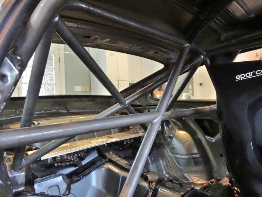

Picked car up from Piper last night. All I can say is man, they do an awesome job! Quality of work and their attention to detail is outstanding,. Highly recommend.
Currently bare metal, but will be painting with Rustoleum Hammered paint this weekend. Nice thing about this stuff is you can roll/brush it on. It is real thick , so it self levels and brush strokes don't show. Also give it more of a powder coat look which allows for easy touchups.

Do the door bars 'kick out' towards the door? Hard to tell from the pic angles. Looks like the door guts are intact too.
Also, PCA stock class allows tying to the frame on pillars? '6C' says you may not tie in to cage to provide chassis stiffening?
