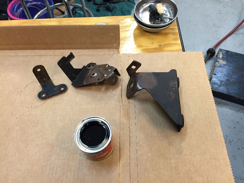

Yeah, so you can see in this last pic that the manifold brackets are in pretty rough shape with rust. Yeah, that won't do, now will it? Some good ol' POR-15 on all the brackets. Also hit the injector bodies (which were surface rusty) and the VANOS solenoids (also surface rusty).

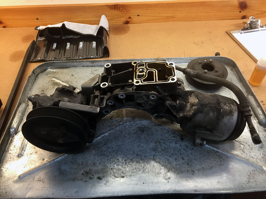

Next up - pull the oil filter housing console. Now, I posted a thread not too long ago about doing this same job on my E90. I have to tell you - on the E46 this job is 100x more difficult. The biggest problem on the E90 was paying $41 for a single use tool to get the bolt off. On the E46? Remove half the shit bolted to the engine. Alternator, belts, tensioner, VANOS oil lines, power steering pump. Here it is one the bench - again, filthy. This thing's been leaking probably for the better part of a decade. $4 gasket and a metric ton of PITA and that problem goes away.

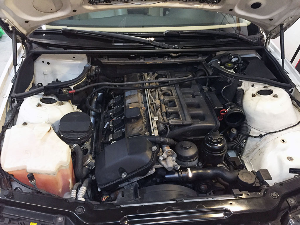

Finally, remove all the other hoses/lines, plug up the open holes and clean, clean, clean. I pulled the thermostat and water pump for pre-emptive replacement as well. The thermostat was cracked up on one of the connectors and I'm fairly certain the water pump bearing are on their way out, so I'm happy with that decision.
So clean:

I feel strange in discussing the need to clean parts very well before re-install with you but a quick lesson learned: When you removed the oil filter housing, you exposed the clean side of the oil circuit supply to the VANOS. One piece of crap in the clean side and it may mess up the VANOS. The good news is mine needed replacement anyway - Mine failed very soon after I replaced the seal.
