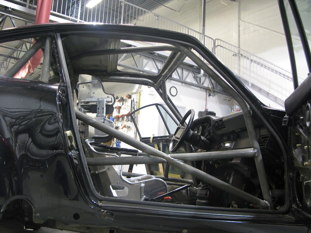

And I also got some cage photos from Piper.
Name:  Cage interior right.jpg
Name:  Cage Drivers Side.jpg
Name:  Cage Passenger Side.jpg
Notice the neat mechanism for raising and lowering the driver's window - so I can drive to the track!

Holy crap -- your garage is huge! Damn, it even has a mezzanine!
How did the scissors lift work for you? Did you have to tackle anything where the lift was a hinderence vs a 2-post?

(warning: Im a blunt engineer) IMO, thats a terrible window net setup. Looks like that lower bit will tear the ass out of your suit within the first week of using it (though Im guessing its supposed to 'drop down' - until it gets accidentally bent, catches on the bar padding, etc.) Too far back too (or just too small).
