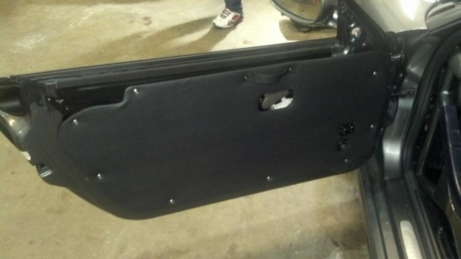

Car almost done. Just got it back from Lims who did an awesome job on the door panels. Only $240 for both! Went with screws instead of hidden fasteners for easier removal and durability. Window and mirror switches relocated to bottom right of panel where the old speaker used to be. Allows access with door closed because gap in rollbar. Plus didn't have to modify the door at all. Well except charlie created a bracket to hold the door cable leading to the "gasp" fofo handle.
Only Motor mounts, passenger side door handle, and PIWIS programming left. Unfortunately graphics can't be done in time so will do that when I get back from Sebring
