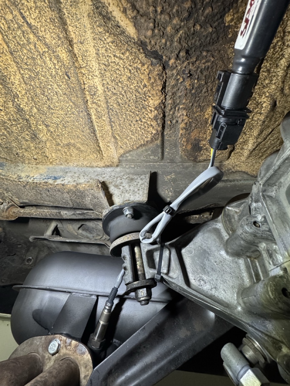

First, I installed the new muffler and O2 sensor, and connected the sensor to the converter:
