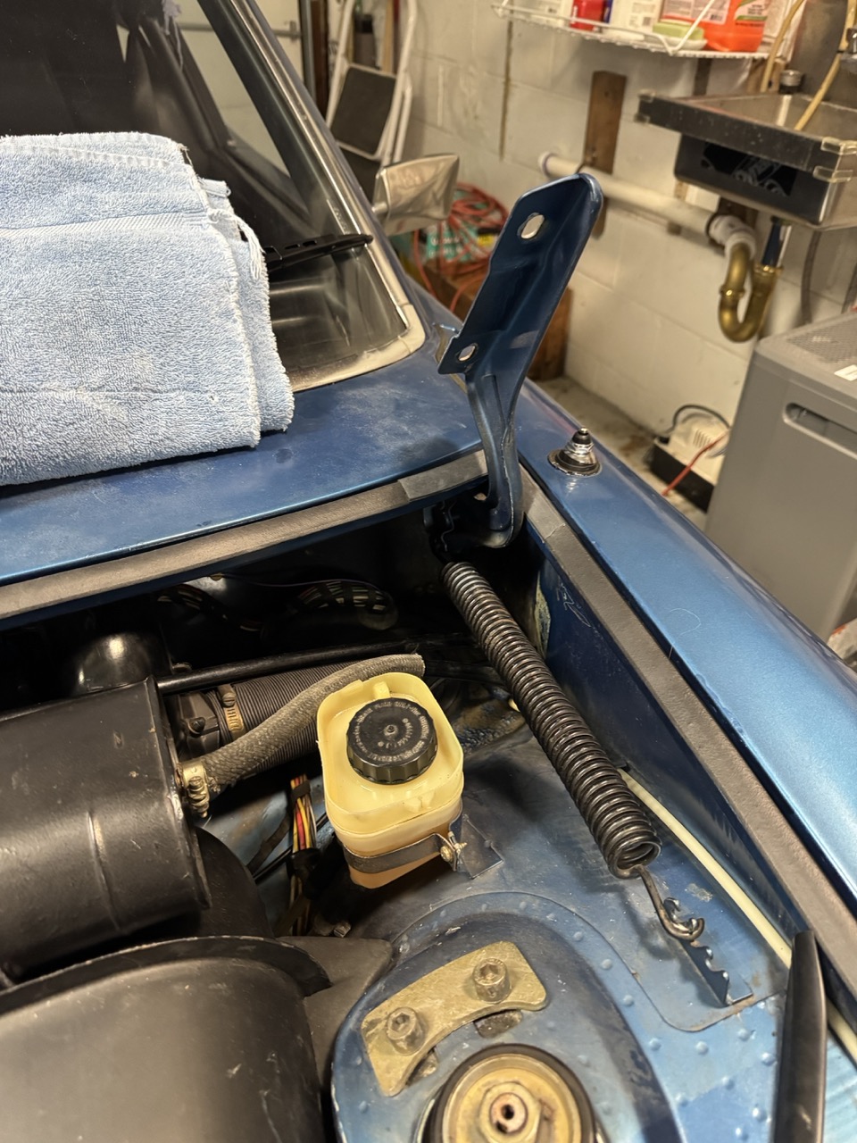

Between waiting for the parts and spray paint to arrive, and being at the Summit Point Club Race last weekend, I wasn't able to get the hood reinstalled until last night.
Here's the "new" bracket (cleaned, de-rusted, and painted) next to the old one:
And the hood hinge installed:
And with the hood itself installed:
My son and I spent about 1/2 hour tweaking the positioning of the hood. It isn't perfect, but much better than before.
