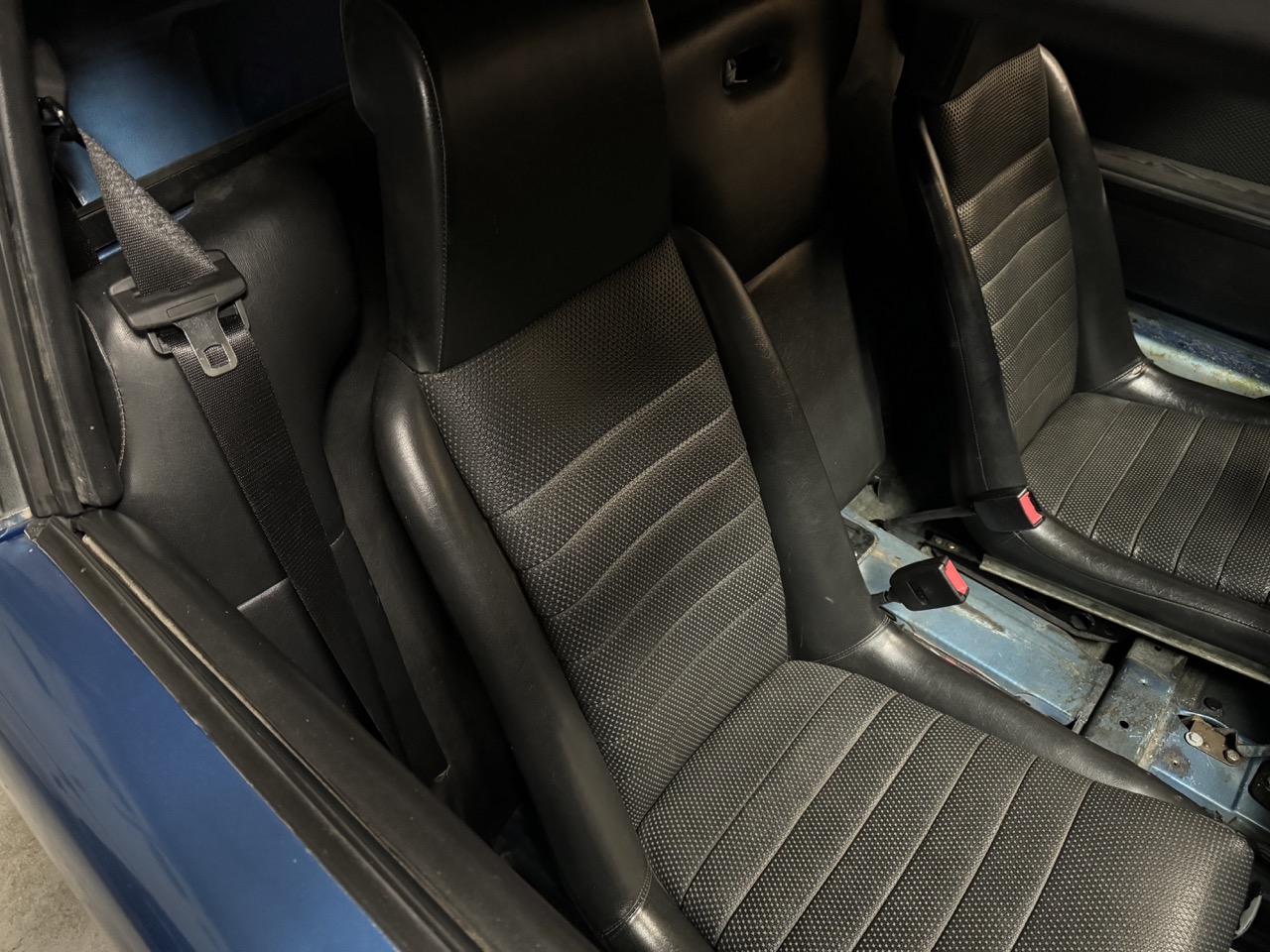

First was installing the new seatbelts from seatbeltplanet.com . Decent kit, mostly plug&play, but did require some modifications. First, a few of the mounting holes needed to be opened up a little to use the stock mounting bolts. The bottom seat belt tabs needed to be opened just a little to fit the plastic bushings. And, the center latches needed to be drilled out as well; 14mm would work, but the 9/16" drill I had was close enough.
Second, the kit does not include the bent wire guides that are used on the stock seatbelts. These guides are important because the space the seatbelt reel away from the firewall, and they also keep the belt from rubbing. While I could have cut the old belts to get the guides off, there's no way I could have gotten the guides onto the new belts without modification. So, I modified them. I used a cutoff wheel in the dremel to slice through the factory welding.
Then, I was able to spread the guide to get it off the old belt and onto the new belt. Once that was done, they mounted just like the stock reels.
And, after it was all done, it looks pretty much stock.
Only difference is the new seatbelt latches don't have any wiring. Unplugging the old latches had the effect of disabling the warning buzzer, so I'm okay with that. I could have used the new belts with the old latches, but the catch tabs didn't fit very well into the latches, and the old-style side release buttons are supposedly not very secure compared to the new-style end buttons.

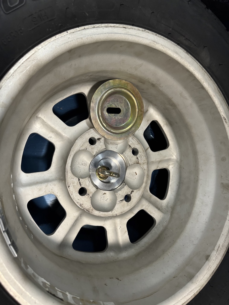

Shortly after I got the car, I bought 5 new 195/65R15 BF Goodrich tires. Nice tires, but noticeably "fatter" than stock tires. Being fatter, the hold down screw for the spare no longer reached the thread at the bottom of the spare tire well using the stock hold down plate.
My options were getting new tires before these wear out (not gonna happen), making an extension for the screw, making a longer screw or making a new hold down plate.
I chose the latter option. I used a hole saw to cut a piece out of some 1/2" aluminum plate I had. I then turned it down in the lathe and finally cut a slot using the mill.
The new plate drops the flange surface about a half-inch lower, allowing the screw to reach and hold the tire down.
