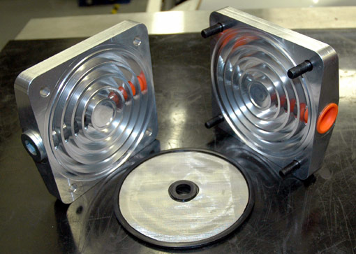

For you billet fetishists out there a nice shiny 6 inch O-berg filter. A metal and filter screen sandwich of sorts with good flow. They are also easy to open and see what it trapped. Easy to make too. Start with 6 inch block of metal and machine 92% of it away. I set it near the back close to the rear firewall but far enough to leave a curve of -16 line into it and out. This way I can lift it up out of its mount and slide a pan under it when servicing it but when it is in place the lines are snug. Thats the plan anyway.

Ecurie Racing runs them in their 356s. Typically located off of the front fender oil cooler lines, under the hood, in front of the fuel cell for easy access.
It's a nice setup and unfortunately I've seen them after an engine grenade and the filter really does work!
My 356 is plumbed similar [filter under the hood] but have / am using large fram racing orange spin on. Might convert it to o-berg b/c of ease of maintenance and I need some more bling. .
Wonder which setup weighs more ...
