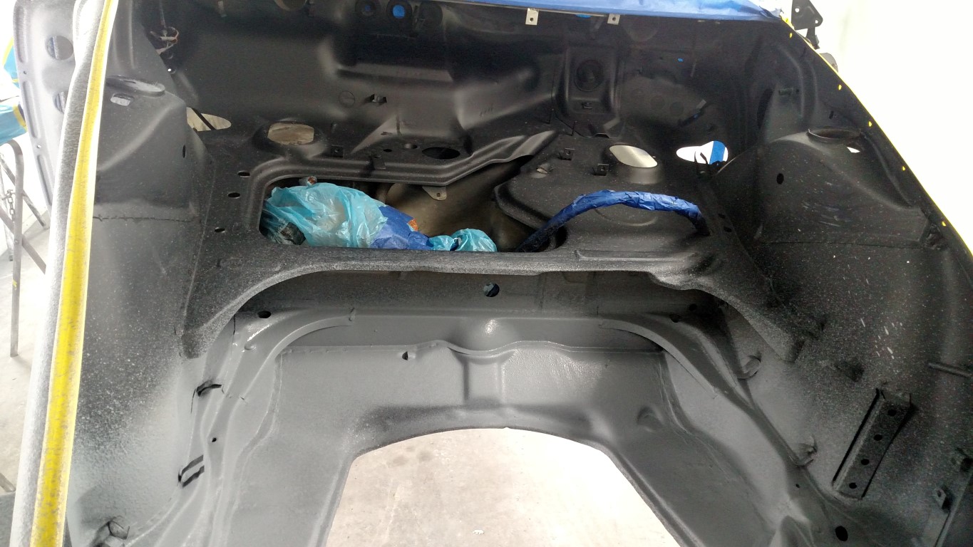

DP
  #112

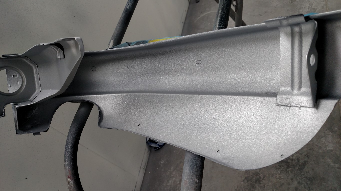

scotty b
shiny shot

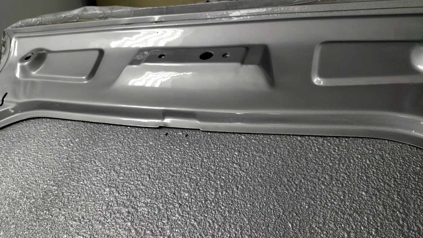

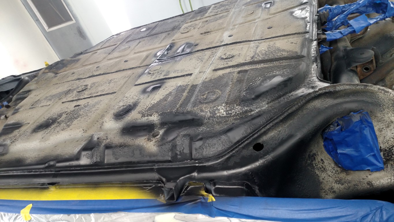

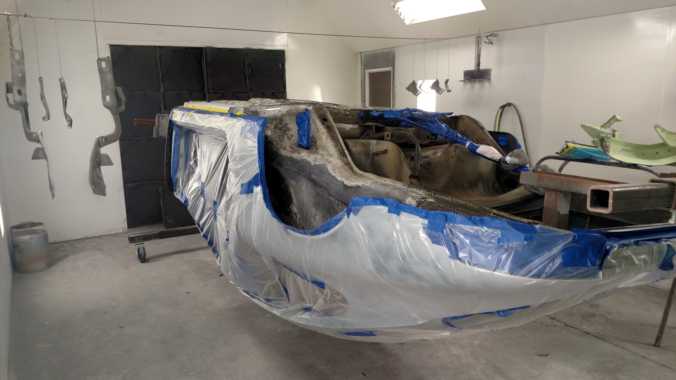

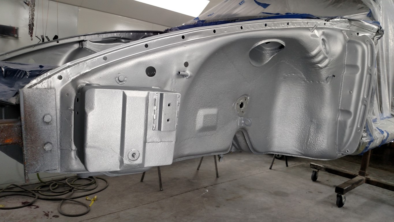

Thanks for posting the pictures, it start to get real.
I see the issue with the POR15, this was overkill, and didn't help . An other lesson learned

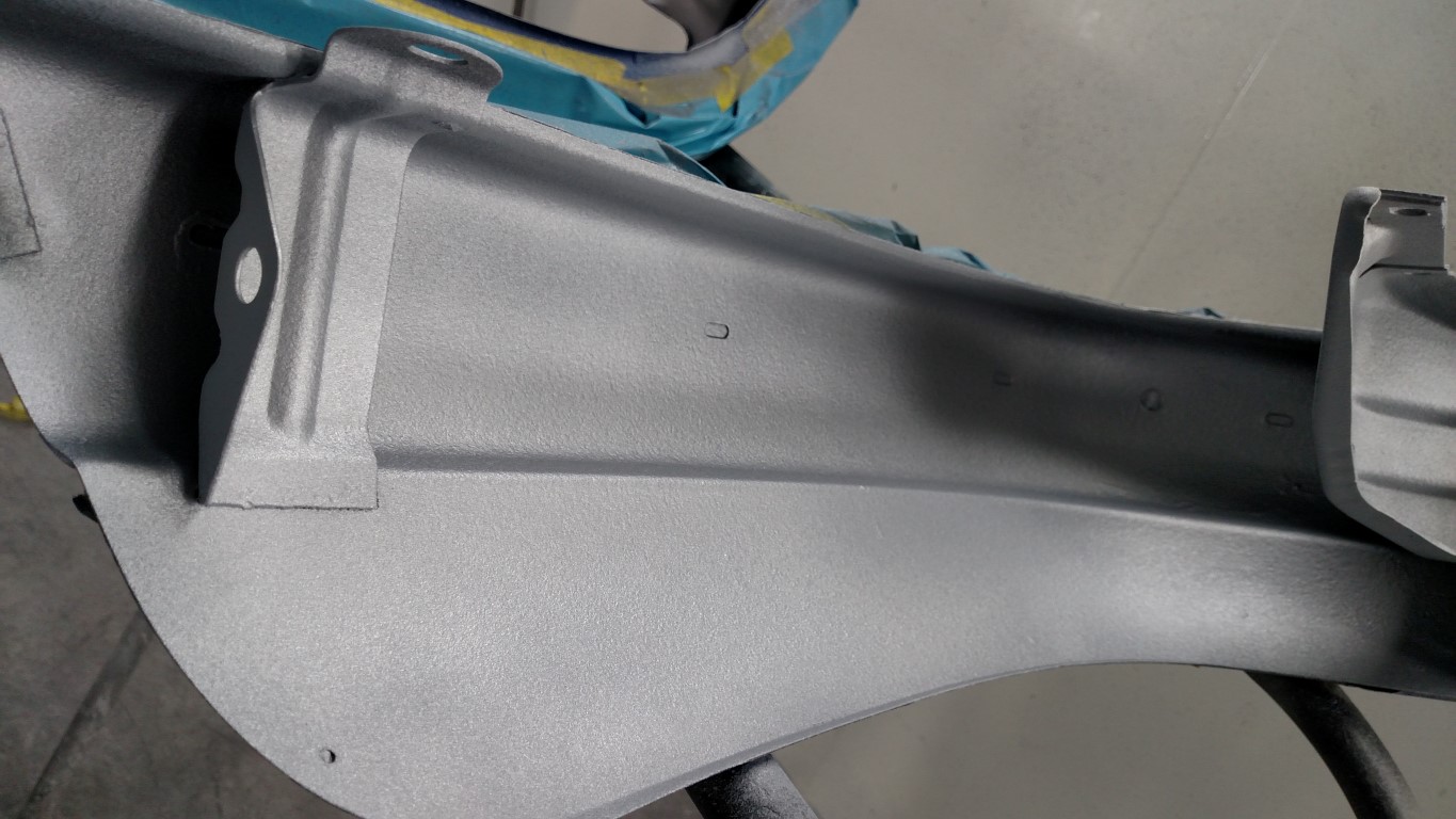

Very nice work all around. I like the side shot of the just right gray / black primer layers.
I found that POR-15 is great on pitted grade rusty metal but not so good on clean or even flash rust metal. It ether bonds real well or it can be flaked of in sheets. I have removed bad areas with ease using compressed air by shooting a jet at an angle against an open edge or scratching it with some 36 grit. when it does stick it seems to hold on well and it pulls into seams well. I now mostly used it as temp preservative to stop further damage on stalled work and as a pre seam sealer of sorts. (this might or might not be a good idea BTW) Paint it into the seam real wet and wipe off excess with some solvent after 20 seconds. The idea is to seal and lock the inaccessible rust in the seam.

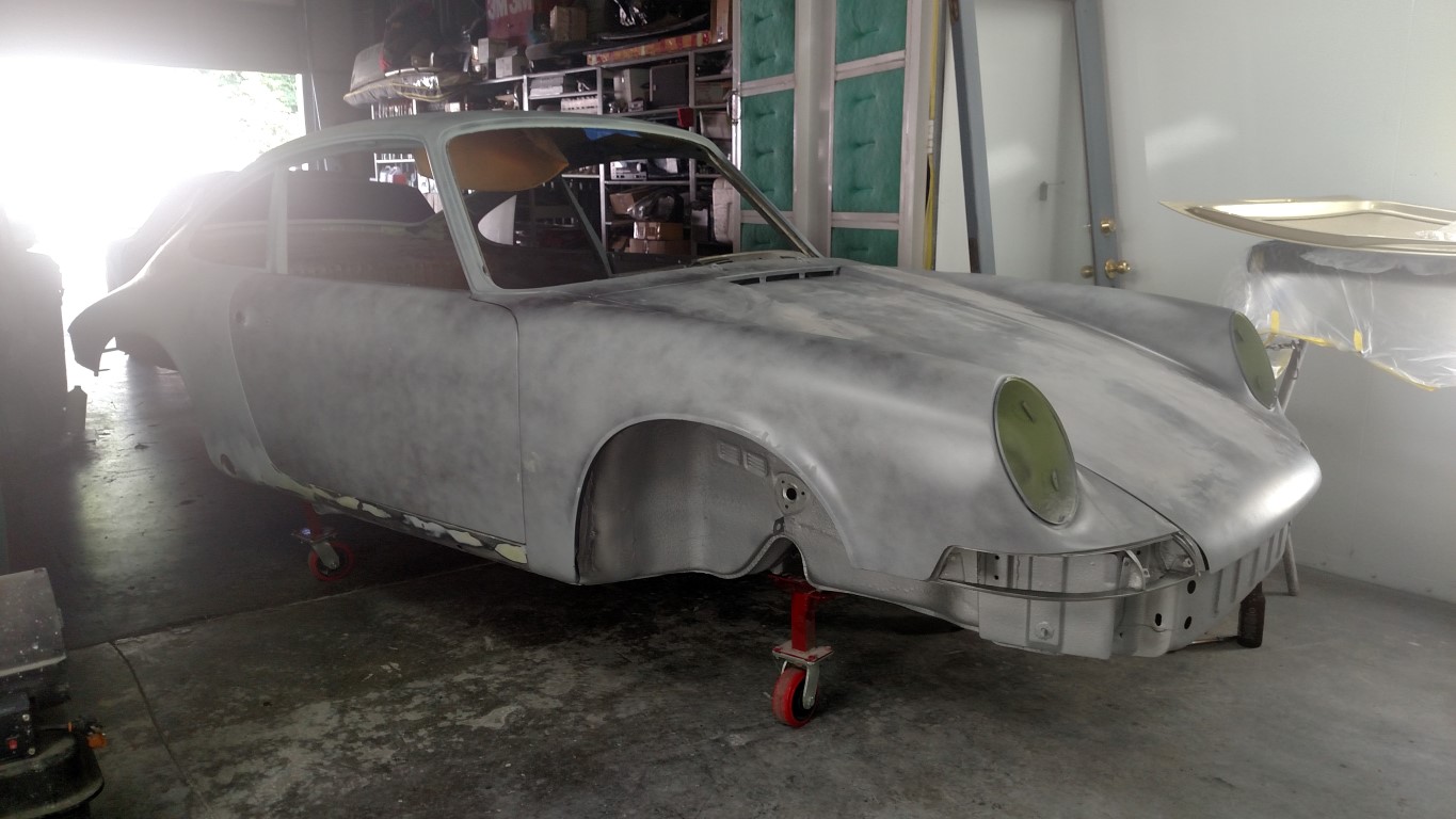

Pics from last week

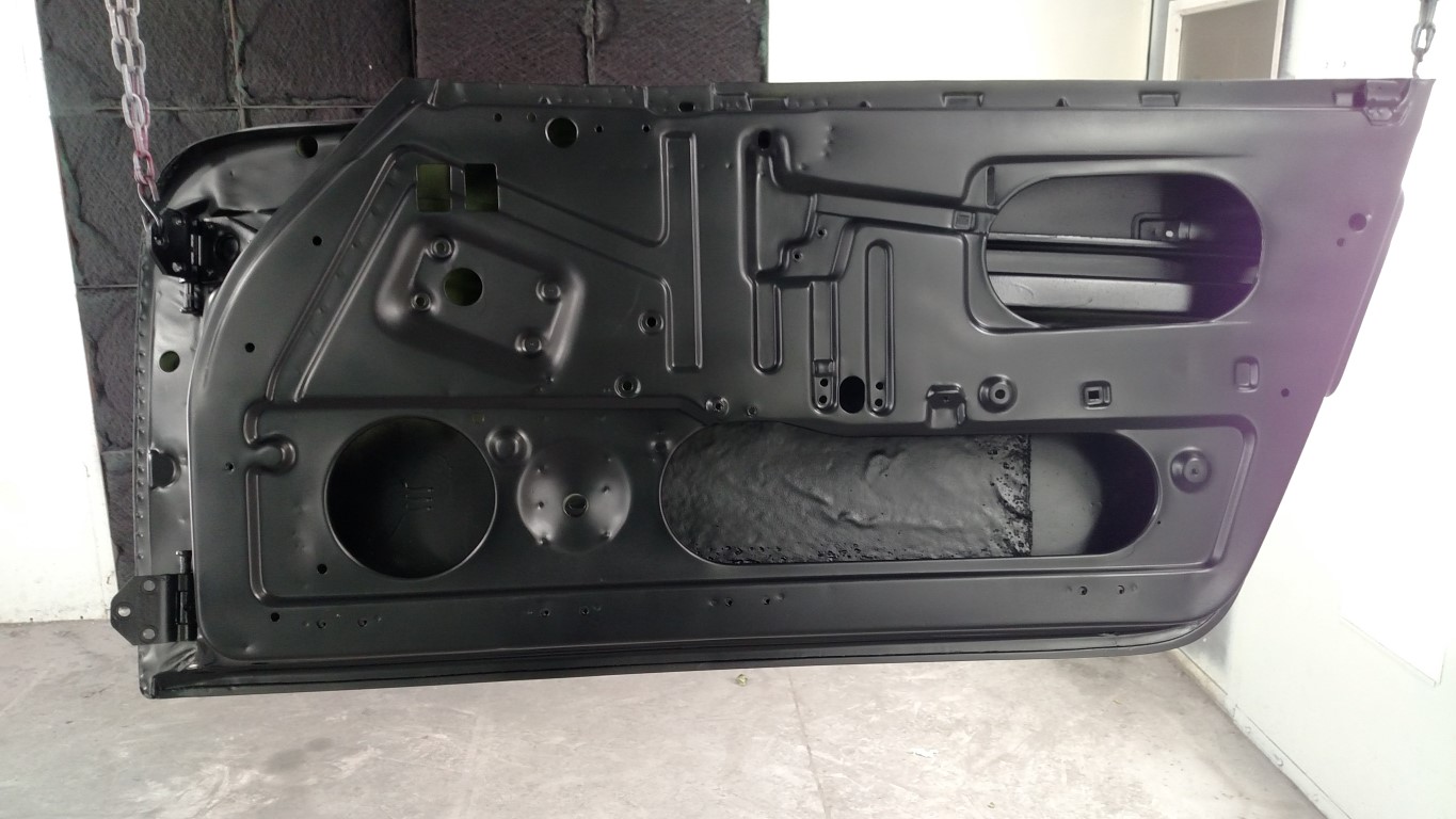

last few
