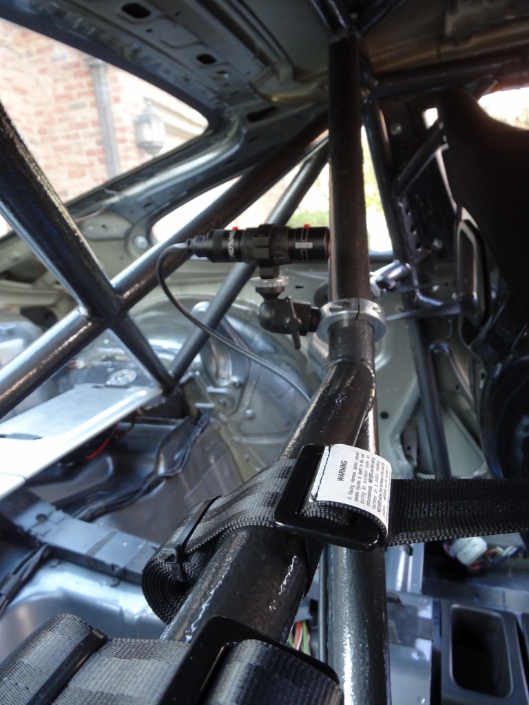

Replay 1080HD: This was kind of a PITA. I rate the hardwire kit a 10 out of 10 for function and 1/10 for design. The wire has 2 huge ends on it. One that screws into the back of the replay camera, and the other which is the remote control. Neither end is removable. So running the wire behind/thru the dash and around the rollbar proved challenging to find spaces to squeeze it thru. Then, the mount for the remote unit has a tolerance of about 1/16th of an inch. In other words the lip of the bezel only has 1/16" lip. If your mounting hole isn't exact, it will pop right thru! Piss poor design.

CM200 Radio: This was the most work of all. Wanted to mount in the center dash, but no DIN adapters available to make it easy. Instead Modified the bracket that came with it. Luckily the heater control had gaps behind the faceplate, so screwing the radio adapter down in the center dash worked!. The screws to the radio from the bracket come in from the side. I had to remove lower dash (PITA), glove box and a bunch of other stuff to get access. Ended up dremeling some holes in the side of the center console to be able to access the side screw locations in the radio. Trim plates cover up the holes, so no biggie. Ran the harness for the PTT button below the steering column, and ran the headset wire into the center storage tray. Nice place to keep it when not using it! Drilling a hole in the roof for the Antenna was easy, but a few flakes of metal ended up on the paint (even though I had it covered. Not realizing they were there, wiped the dust off the roof, and put a few scratches in the clear coat. Charlie runs VHF, so the antenna is a giant brick. Might get a UHF antenna instead (says it not for use with VHF, but saw them on a few Interpsort cars and they seem to work ok)
