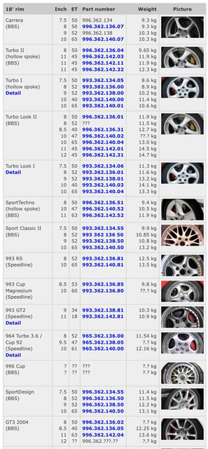

Here is a partial list of factory 18” wheels that fit the 996.
We went with the Sport Design wheels on my son’s car and a set of 997.1 18” wheels, not listed, on mine. How do the size and offset of the Panamera wheels compare to the ones on the list?
