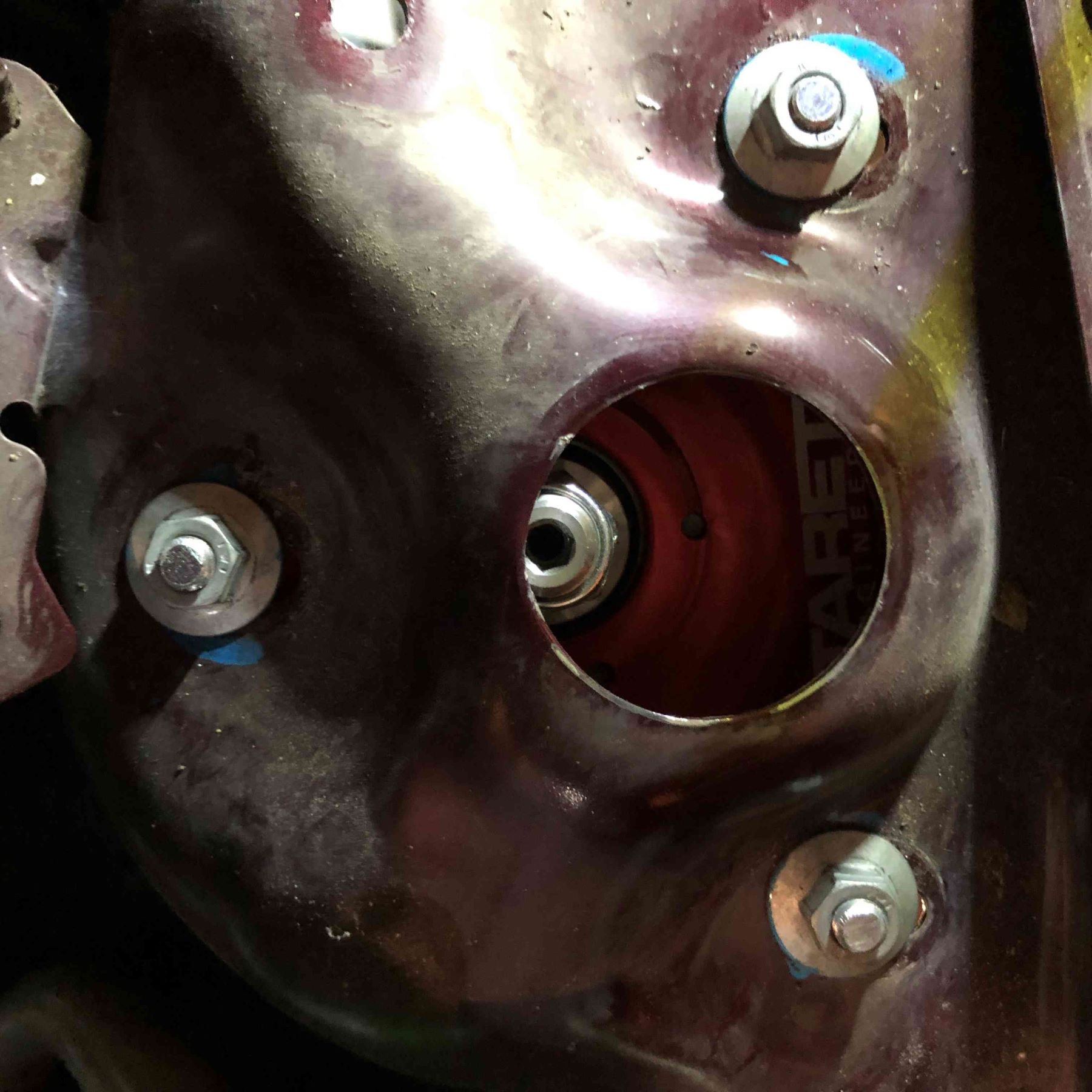

To give an update, with the trip to NC, the progress has been slow with a couple of unexpected twist.
I assembled the rear struts with Tarett monoballs based on the assembly video from Ohlin, but something did not seem right. I called Tarett and Ohlin, and learned that Ohlin momoball which is also sold by Tarett has a different design to eliminate using the rubber top mount. To use the Tarett monoball, I had to modify the rubber top mounts that Ohlin includes with the struts.
Anyway, I trimmed the rubber top mounts to make them fit this morning and assembled the front (with new Porsche top munts and rear struts. I also bought a tie rod removal tool to remove the tie rod. Mark wasn't kidding about stand back.
I hope to drop the first strut tomorrow. We'll see how it goes.

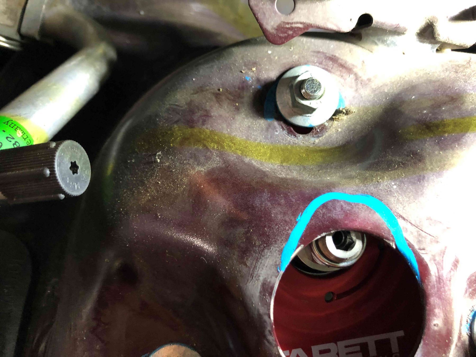

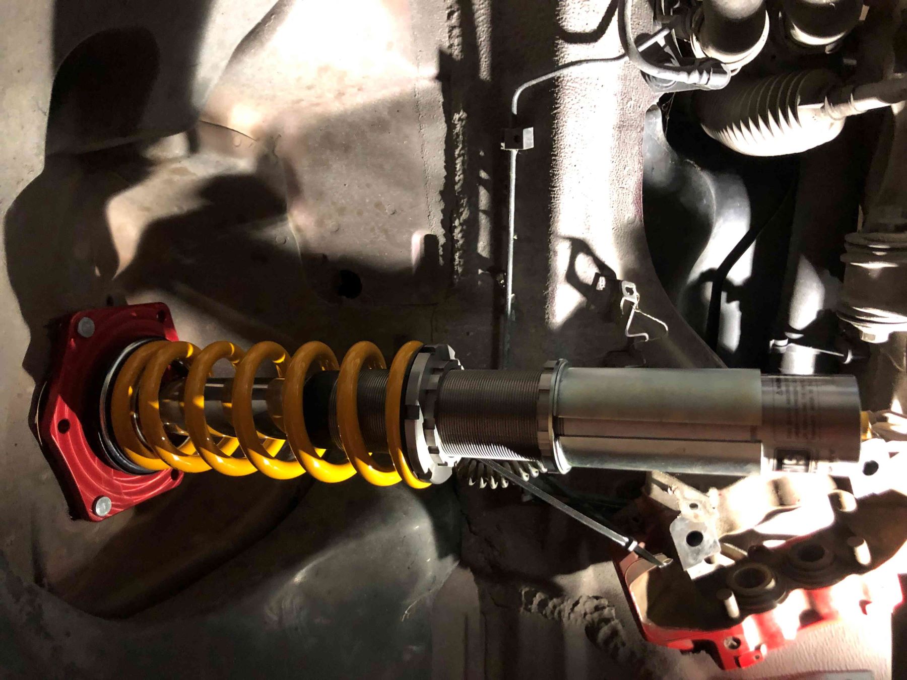

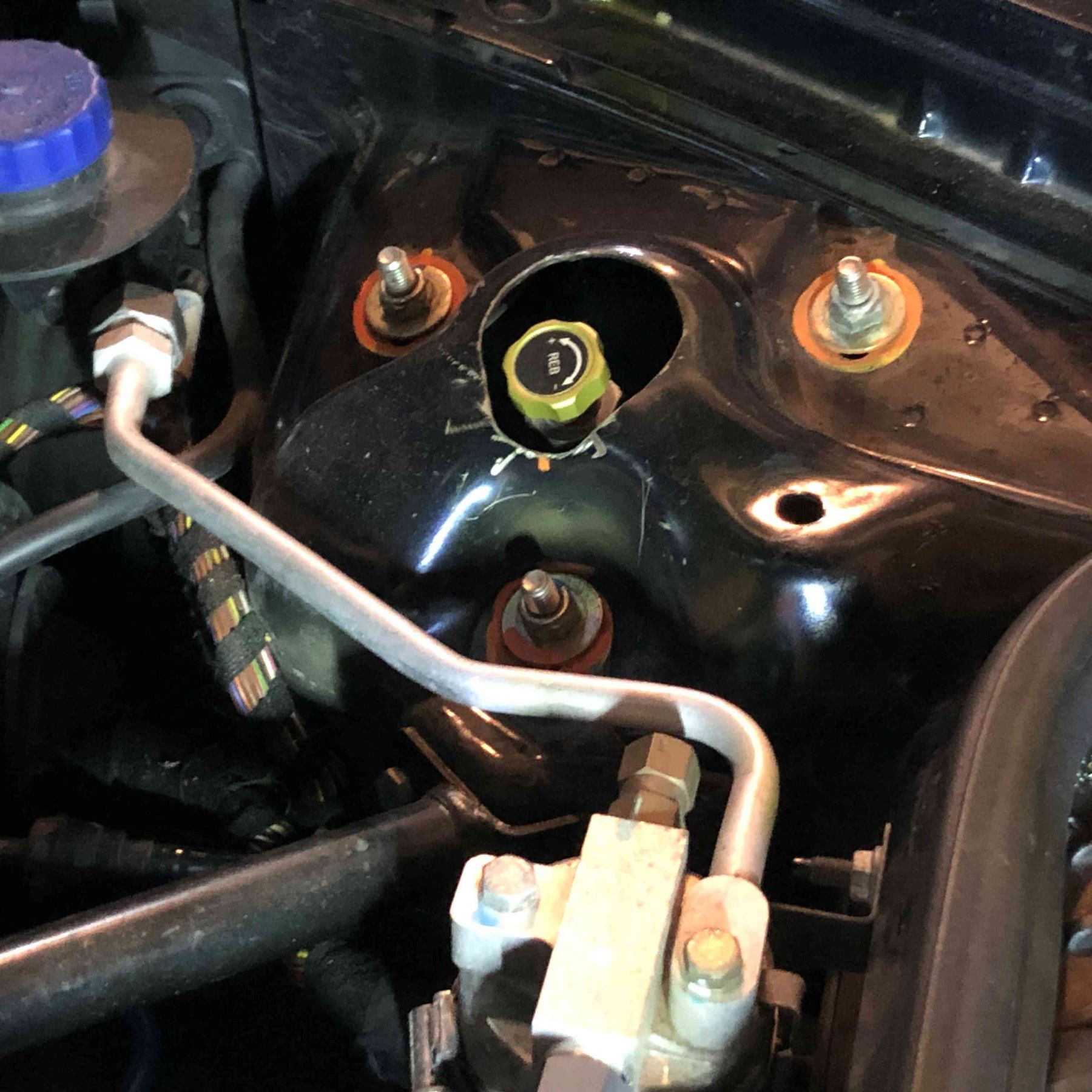

The rear of the car is mostly done. Need to tighten the brake caliper nuts, put in the new pads, and put on the wheel studs which arrived today.
I have moved to the front of the car. I removed both struts. Removing the ball joints and loosening the lower control arm avoided the need for a spring compressor.
I hung one of the new struts just to see the fit. The top mount nuts are not fully tight. The shaft is making contact with the body. I looked at the GT3, and it looks like that the body work around the whole where the stock struts fit has been trimmed to get the Motion Control to fit.
I think I have to trim the area that I have marked. I will be consulting a professional who may have installed one or two of these before.
