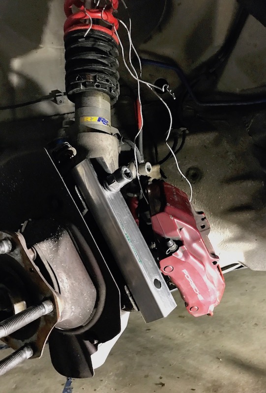

I pulled the threads right out of my front caliper yesterday. I'm sure this was partially caused by overuse but I also have a strange problem with the calipers. The inside of the caliper bolt holes have become threaded somewhat and the bolts don't slide through. I have to screw them through. I believe this leads to the possibility of the bolts pulling on the wheel carrier threads when installing them. Especially if the caliper isn't flush with the carrier. Has anyone else's calipers done this?
Martin and Ion came over last night and helped me install a Time-Sert. We'll, actually Ion did all the work and Martin and I most watched. and learned.
Size:  149.5 KBName:  IMG_6668.jpg
Thanks so much Martin and Ion for saving the day and 987kmns and Ion for building the jig.
I'll be installing caliper studs before the next event. Should have done that a long time ago
