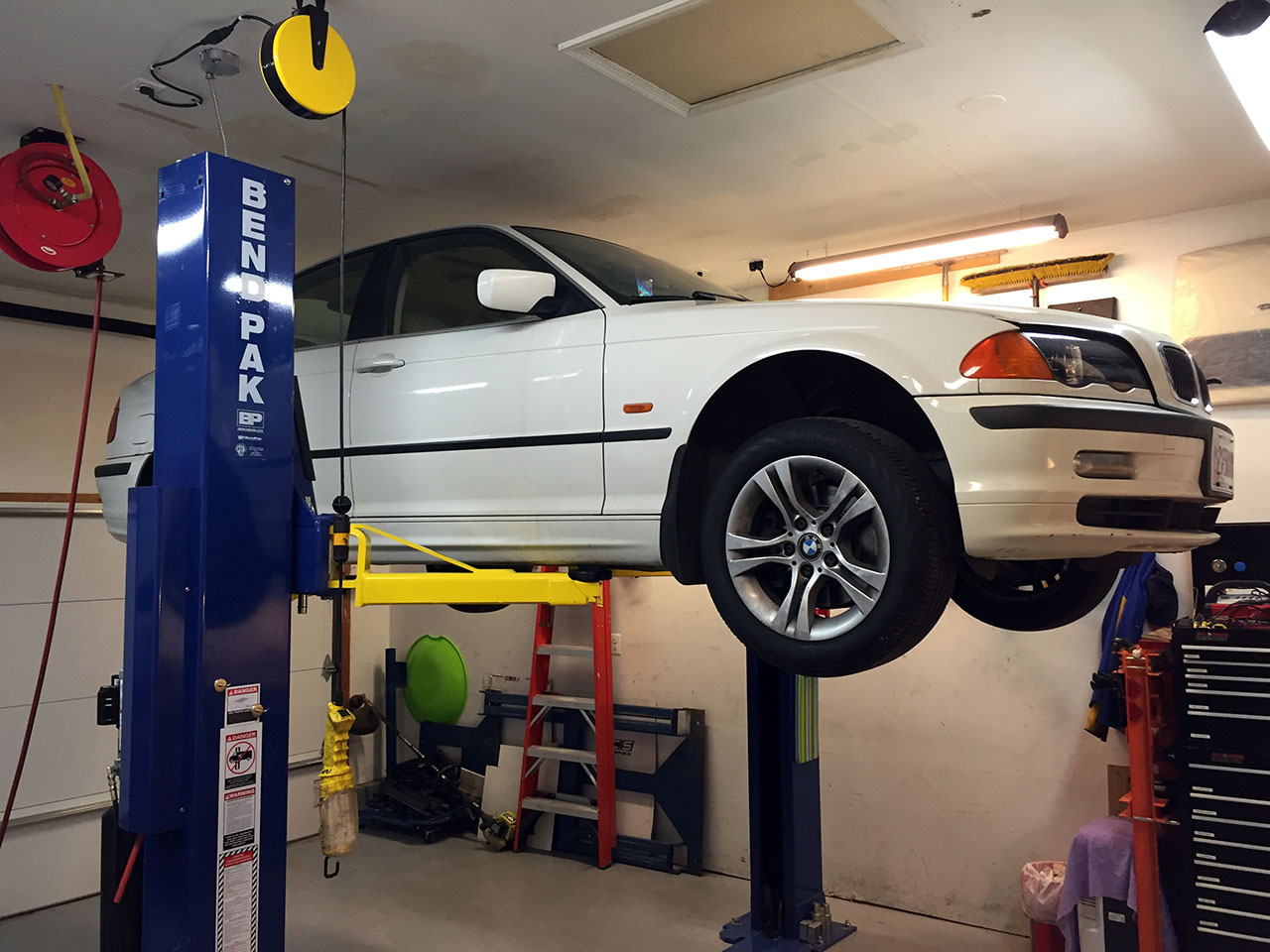

So project E46 went on a little hiatus (much to the displeasure of my daughter) whilst I got the lift installed, then the garage rejiggered, and then her brother's Maxima spent a week on the lift getting repaired. All of those things sorted out and we're back to this:

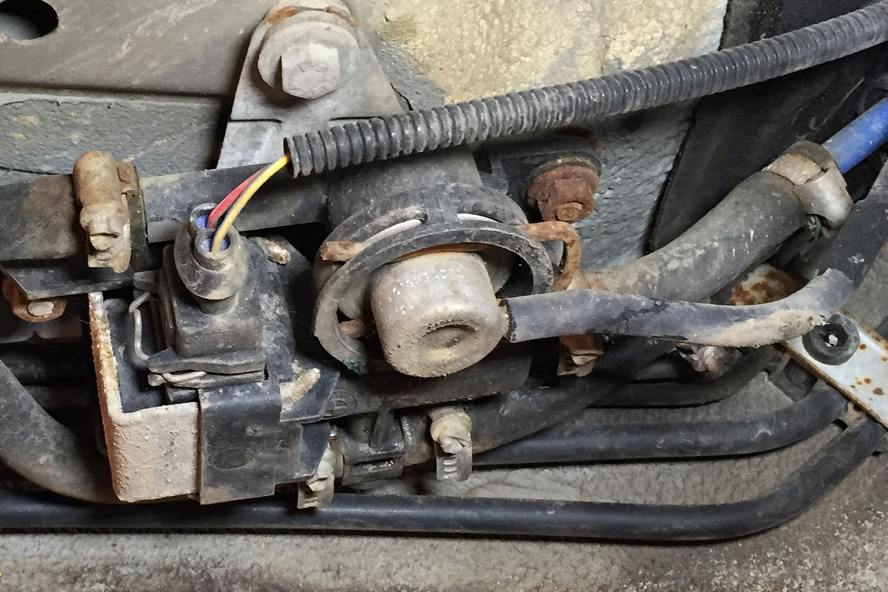

So, what treasures are lurking underneath the E46? Well, the first thing that caught my eye was the ghetto fab fix for the bad dif bushings. Yup, those are coolant hoses (from a Ford, for those who care) stuffed up behind the dif and zip tied to the subframe. Also, I strongly suspect there is more oil in the dirt caked on the side of the dif that there is inside the dif itself.

Motor mounts aren't looking too hot either:

With the right tools (2 post lift, transmission jack, air tools) this was a 3 hour job start to finish. If you like to work on cars and don't have a lift, go buy one. Can't fit one in your house, sell your house and buy a new one. Seriously, this would have been a weekend project before and at the end of the weekend my 41 yr old body would have been looking for vicodin. Instead, this was a 3 hour start-to-finish job and the next day I feel fine.
