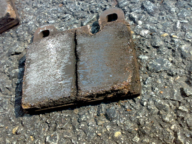

If you're buying new brake pads, get a decent set of high performance street pads like Hawk HPS instead of $20 Mintex.
Absolutely do not use the $20 Mintex! Here's what a brand new set looks like after ~10 minutes on track. Garbage.
