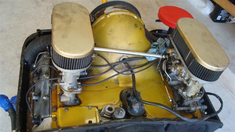

UPDATED
Well after cleaning up the engine and tightening all loose head studs, I ran it and found only one oil leak at the rear main seal. Unfortunately it was a very big leak. So after talking with my helper (who is much more knowledgeable than me on 911's) we decided to drop the engine and go for a complete tear down. We finished the disassembly today and were very pleased to not find a lot of broken bits or tired engine parts. In fact it came with 90mm Mahle P's&C's and a lightened flywheel. The engine does not show much wear at all in fact the cylinders look almost new! I need help ID'ing the pistons though. There also wasn't much carbon build up and the one cylinder with the lower compression (175) had a broken head ring seal. It does have the original sized valves which seems a bit too small for 90mm cyl's. Also will need to figure out how to lower the compression. I don't see the need for 200psi. Lots of pics attached.

Wow! I realize one cylinder was leaky, but can't you replace the RMS by just splitting the engine from the transmission (i.e. clutch job)? Good luck getting it back together in a reasonable time period (although I bet it will be great once done). How do you determine the appropriate valve size for P&Cs, and how do you lower compression without changing P&Cs?

I should add that it wasn't running perfectly and we had no idea what the condition of the engine really was. So since this was purchased as a project, we decided to go ahead and do a tear down so I can be sure of the condition of the engine. That way I know exactly what I'm up against. Plus I can do all the other fun things like suspension work, painting, carbs, etc

So I guess the engine can go back together with just a couple new seals?
You should send off the carburetors to bieker performance and have them line bore and rebuild them. Then you will have new Webers. |
#36
New seals and bearings and few new rockers and shafts (three had scarring on the shafts). I am also considering different heads to get larger valves. Any thoughts?
The webers were supposedly rebuilt not too long ago so I will tear them down to check.

It might just be the picture, but the timing chain looks like it is stretched.
