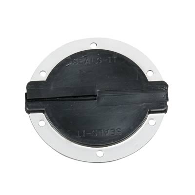

Here you go:
http://store.summitracing.com/partde...5&autoview=sku

Originally Posted by APKhaos View Post
This looks like the way to go. Now I need to find the right place in the firewall. It's not to fun trying to get your head in the pedals area with a full cage in the car. Can you say sore back!!
