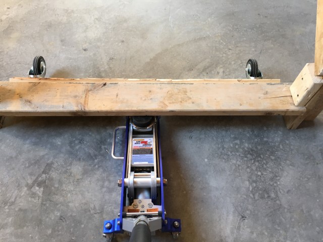

Starting to work on my garage while the contractor continues work on the outside. Since I have 12' high walls, I find it challenging to work up high. Choices are:
1. Work on a tall ladder - constantly going up and down and moving the ladder.
2. Buy a portable scaffolding unit - most are 2x5' and when I need to raise the platform to 6' high, i feel unstable knowing that it seem easy to topple over without the optional safety rails and side riggers.
3. Rent a scaffolding system - not sure how long I need it and the cost would quickly add up.
So, I ended up using the scrap wood left by the contractor to build a platform. 6' high and using a 4x8 sheet of plywood as a platform. This give me plenty of workspace to walk around so I do not have to constantly climb up and down.
As I build the platform (adding reinforcements to make sturdy), the unit got heavier and heavier and became very difficult to move around.
I needed to put wheels on the platform when I need to move it around but want the stability of the structure sitting directly on the ground when in use.
So, I came out with a set of wheels attached by a 2x6 that can swing into place when I need to move the platform around.
I use a harbor freight floor jack to lift the platform high enough so the wheels on the hinged board can swing under. When done moving, I lift the platform with the floor jack again and swing the wheels out of the way.
The unit is very stable and I can work on top for long periods of time.

Very nice looking rig. Swinging casters is a good one too. Was thinking about that for several thinks in my shop. Those that need a steady base but might need to be mover now and then too.

the things we think of when we have to, nice work
I spent a lot of time on a 2x12 between 2 ladders. Not my favorite spot but I got used to it. Also started wearing a tool belt, way too many trips down the ladder for the tool on the floor.
