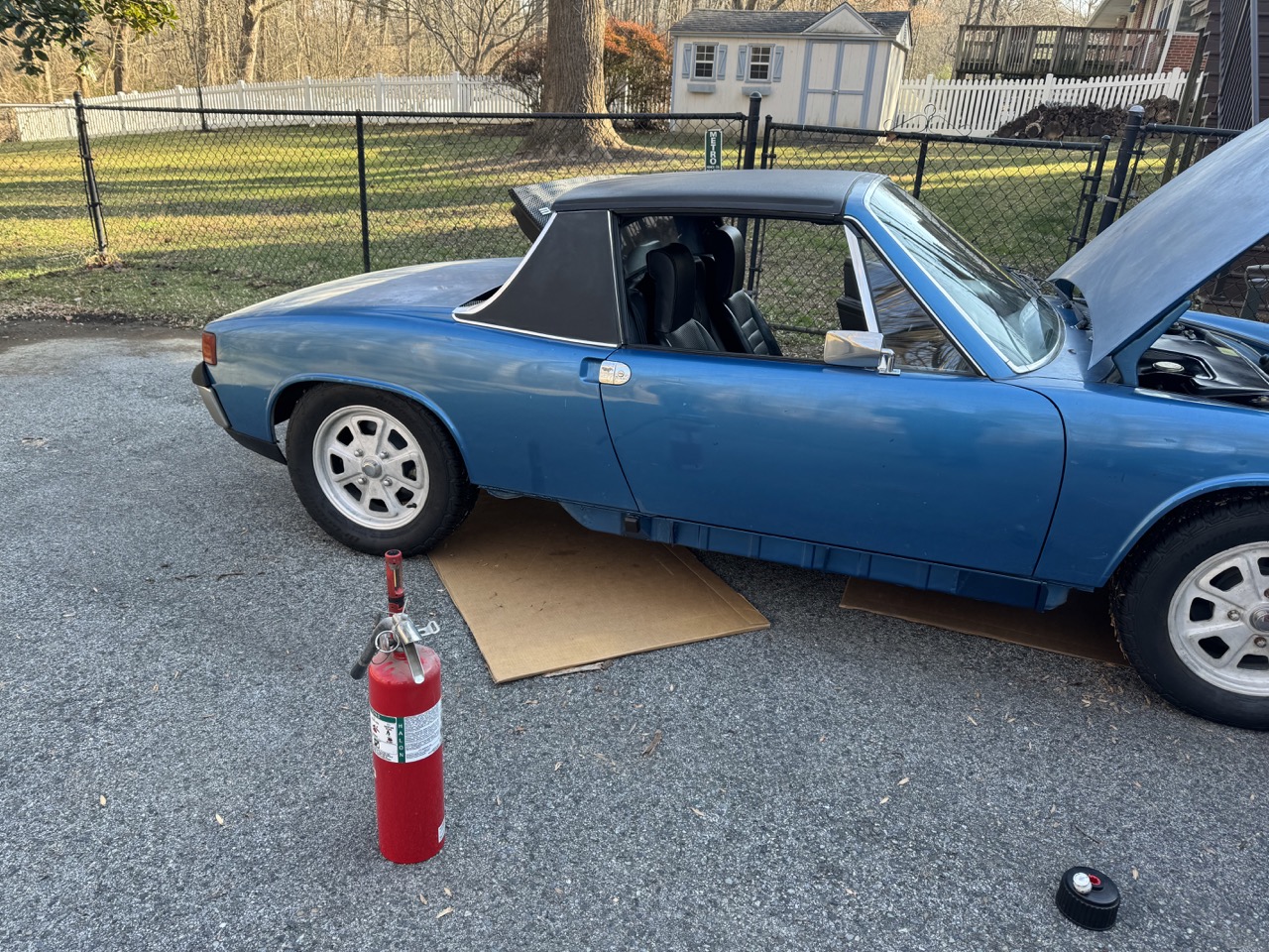

Well, I have good news and bad news.
First, the good news: IT'S RUNNING!
I had my son standing by with the fire extinguisher, as I put gas in it and then started it. It fired right up. And, when it warmed up, I set the timing.
Then, we took it for a short drive, about 2 miles or so. That is now the furthest I've driven the car.
The bad news: the car has issues.
First, the idle is high, like around 1800-2000 RPM. It was originally around 3000, but I found the idle bypass screw on the throttle body and turned it all the way in, which go it down to 1800-ish. I did check that the AAR valve was working (it is), and I even pulled off the hose to it and plugged it with my thumb, but all it did was confirm the valve closed like it was supposed to.
I'm going to re-read how to set the timing and try doing it again. Maybe it's not right yet. Otherwise, I may have a vacuum leak somewhere.
Anyone local have a smoke machine I could borrow?
Second, and potentially bigger issue: 4th gear is locked up somehow. I can get into all the other gears (R, 1, 2, 3, 5), but 4th will only make a loud grind. Once we got home, I stopped on a slight hill to do more testing. I pushed the clutch in and then cycled through each of the gears -- when I let off the brake, the car would roll forward in all gears except 4th.
Anyone have any ideas about 4th gear? Could something have jammed up while the trans was sitting? I stored it in the basement on a couple of blocks with the bellhousing down. I did fill the transmission, according to Dr. Evil's instructions (on 914World), so it shouldn't be a lubrication issue. Any suggestions for breaking it loose without having to pull the tranny?

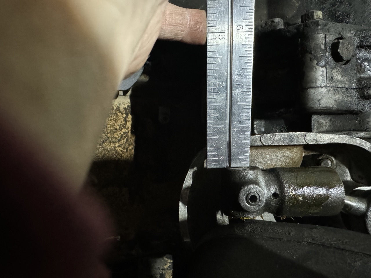

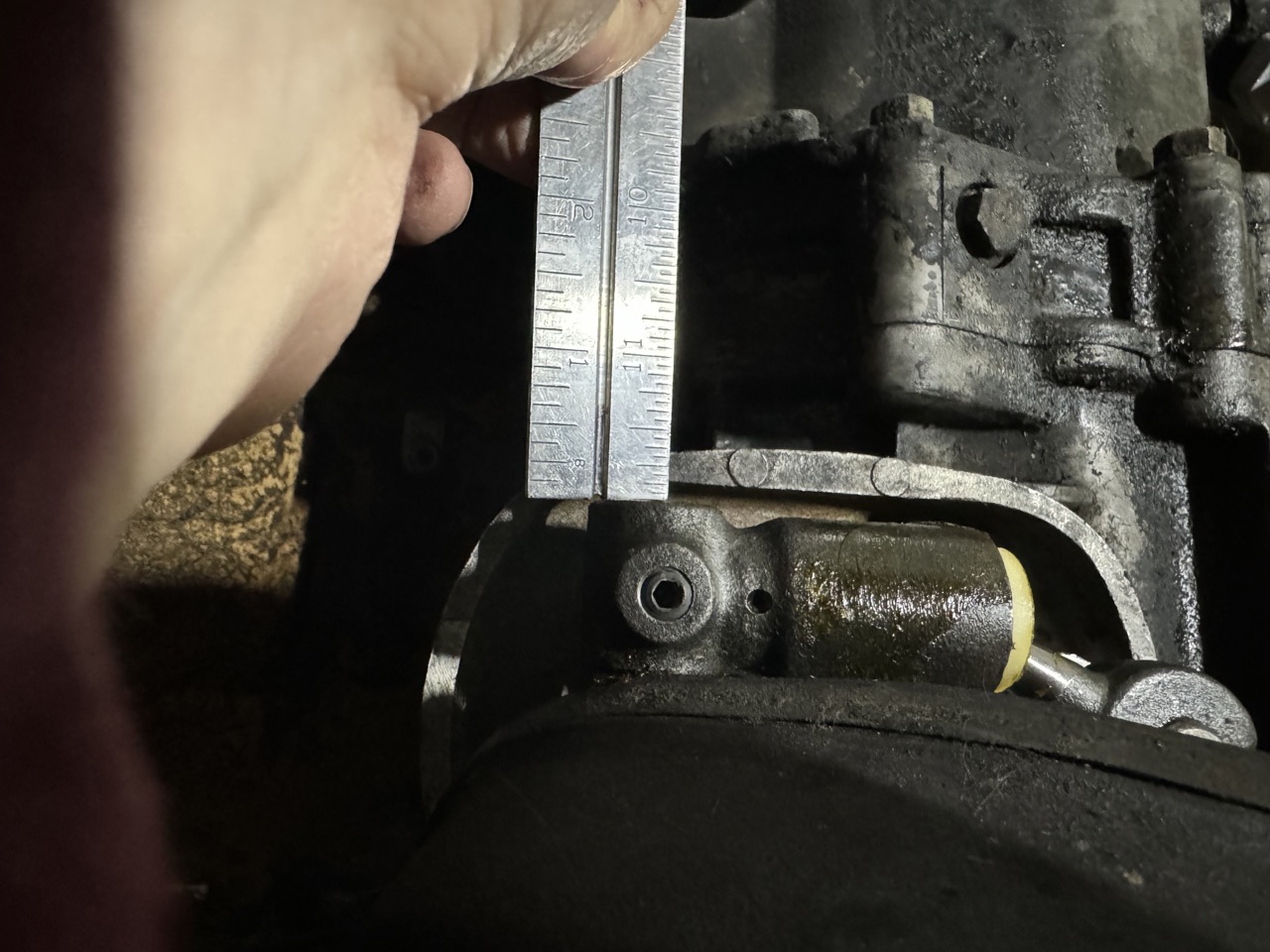

I just spent a bunch of time under the car, trying to diagnose the transmission. And I think I finally figured out what's going on inside there.
I readjusted the clutch cable, but it was fine. I then readjusted the shift linkage, using instructions found on 914World:
  1. Crawl under car, move the shift rod in the trans console to put the trans in 4th gear.
  2. Go into cabin, move shift lever to 4th gear position, tighten clamp bolt.
Quick, simple, easy-peasy.
However, when playing with the shifter in various gears, I noticed the shift lever would go noticeably further forward in 4th than 2nd or reverse. To double-check, I went under the car and measured how far the shift rod on the trans console moved. Here are some pics:
Second gear:
Fourth gear:
For additional testing, I lifted one rear wheel and then shifted the car through the gears. In all gears except 4th, the wheel tried to turn the engine when I pushed the wheel, as expected. However, in 4th, I heard a ratcheting/clanking noise inside the transmission. But, when I moved the shift lever back to the same distance that 2nd had stopped, the car was in 4th and now the wheel tried to move the engine, as it should.
So, the problem appears to be that the slider for 4th gear is overshooting 4th and rubbing on the case or another gear, instead of stopping when on the gear (like all the others).
Any ideas on how to fix this? Bonus points if it can be fixed without pulling the trans!
