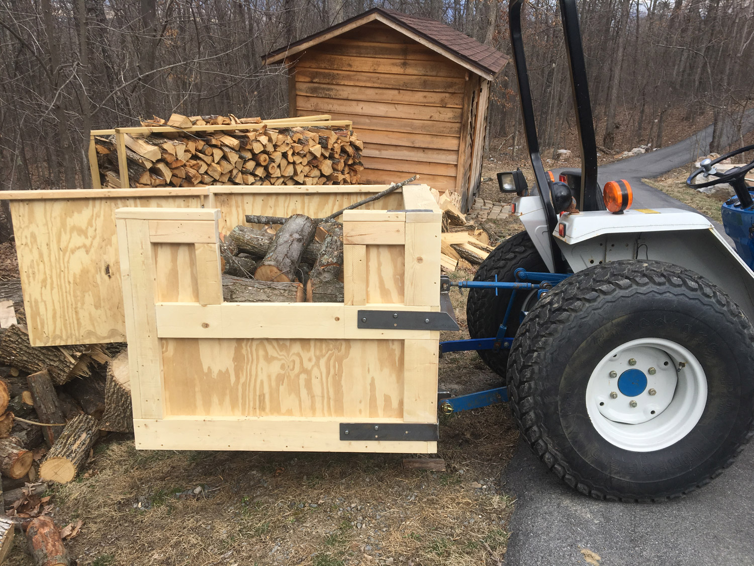

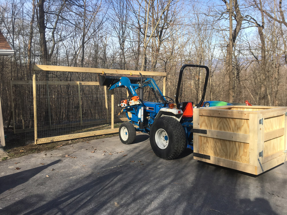

Follow up to an earlier conversation on adding a "trunk" to the tractor. The front end loader (FEL) is a handy bugger for sure but it comes with some baggage. When it is loaded up with enough weight the nice big back wheels are way under-loaded and the little front wheels are often overloaded. More than one FEL equipped tractor has just spun the rear wheels when off balance. They can flop over or sink the front wheels deep in the dirt too. Being 4X4 and having power steering helps but the thing is still less stable when you are chugging around in rock strewn woods front heavy. I almost flopped it over already. One front tire was a bit low pressure and I rolled off the pavement with the fully loaded bucket higher than it should have been. Luck would have it that the low psi tire was also the down hill side. Almost a code brown. And yes....the entire event was watched by the Dear wife thus keeping my rep intact.....

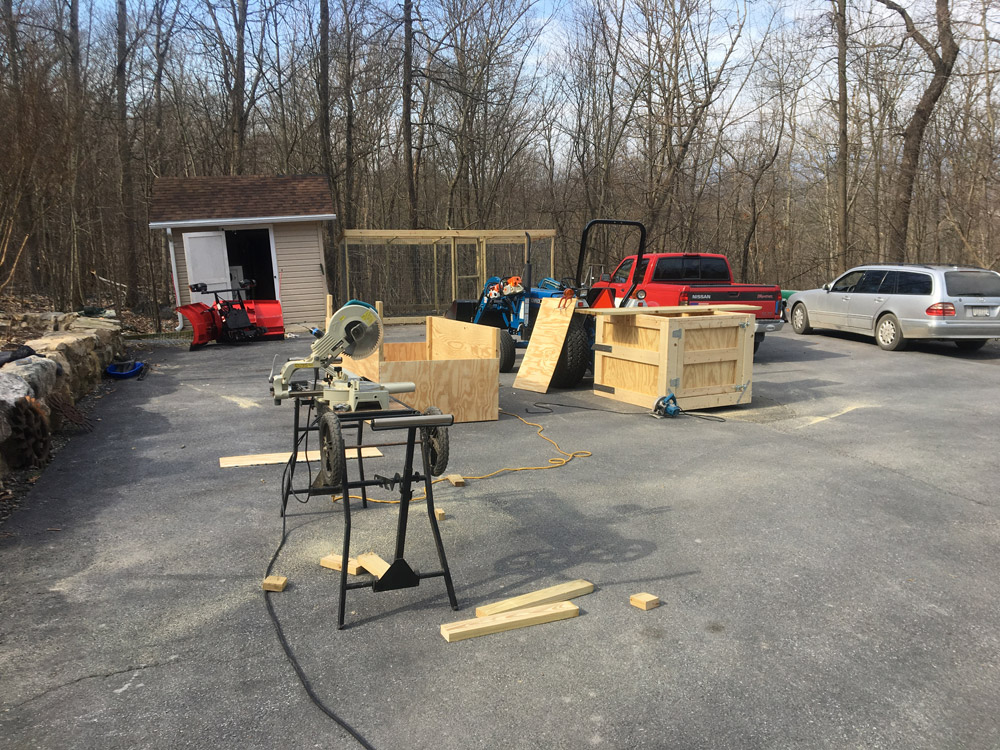

I had previously built a 4'X4' plywood box to hold "up next" firewood in the garage. (Storing 1/2 a cord of ready wood in the garage is pure joy as you don't have to put shoes on and go into the cold to refill the wood bag). I would fill it by loading up the back of the PU at the wood shed then toss it in the wood bin. Toss in truck/ toss in bin. I took that bin apart, reinforced it with more wood then construction glued and screwed it back together. Also added a full width and height rear door for easier loading and a side access so shorter folks can reach in and get at the fire wood.
Dug into the steel drops pile and welded up 2 brackets so it can be attached to the tractor 3 point hitch. Now I can counter a full FEL with a full trunk when pulling wood from the woods. During wood burning season I can drive the tractor to the shed, load the back and FEL then drive the whole mess back into the garage and done. No unloading needed. So far I have found the box to be handy for moving bulky stuff, odd size and smaller wood and people too.
Figured I would use it a bit before installing the little side door and then painting it all up. Built strong but I will need to take some care not to overload the box. The 3 point hitch is rated to 1635 lb attachment lift weight so a chock full bin of wet oak rounds would be close to too much. Put less in or load in the bulky stuff. 4X4X4 is 1/2 a cord of wood. A seasoned full cord is (very) roughly 2200 lb so I am well under there.

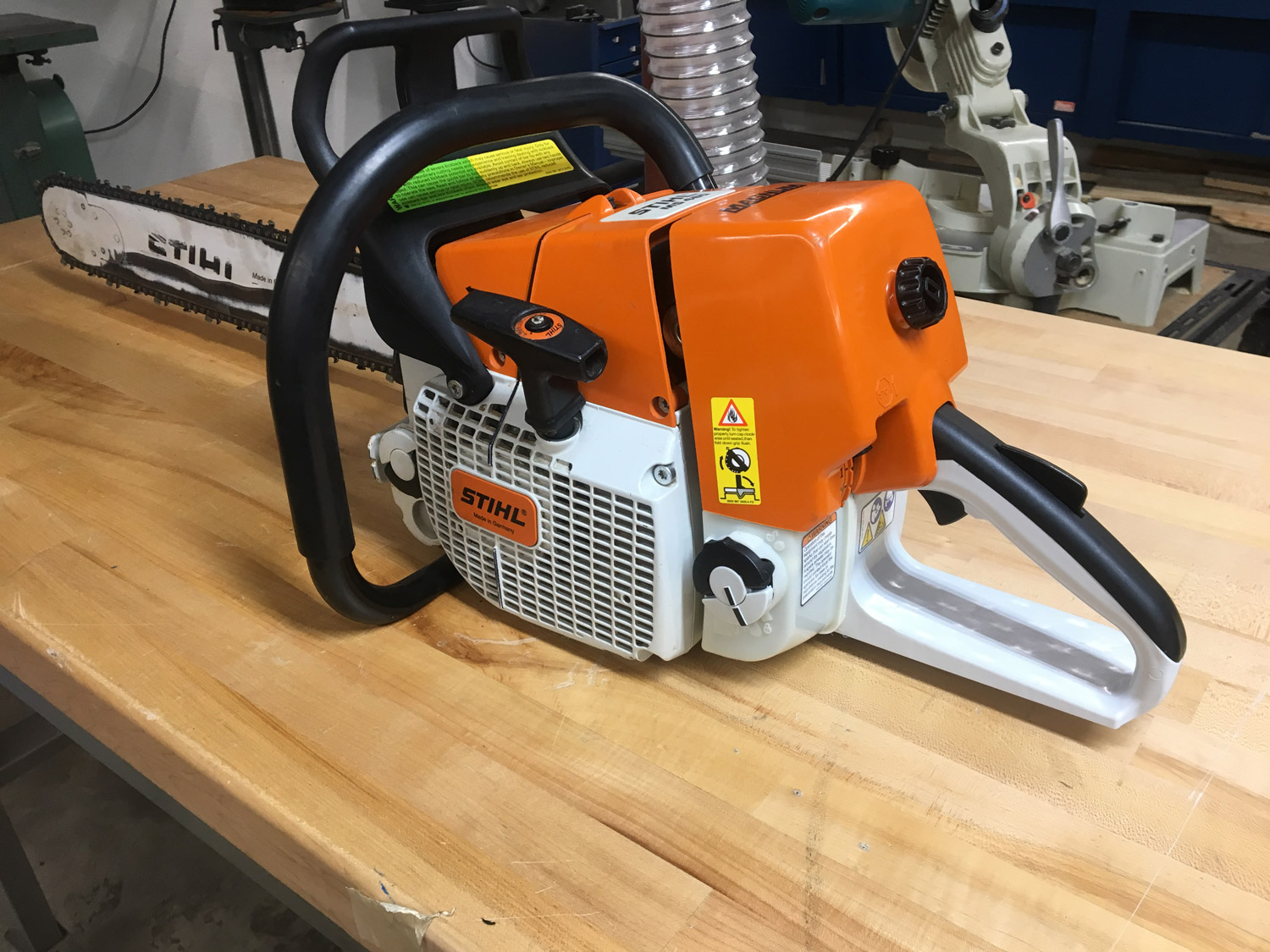

I have been bad to a good friend of mine. I put my Sthil 460 in harms way. I was bucking up a big Oak that had done a long slow fall to earth. Cut up and bucked it from the top down. The trunk was about 3 feet off the ground at the root ball end and 0 at the first branch end. Did a bunch of 3/4 through bucking cuts to the trunk in prep for putting it on the ground. Got to the root ball end and got the saw stuck. Hmm, did not calculate for twisting. Took some logs from the top end and put them under the trunk to catch it when it fell. Put the tractor bucket against the log so it had to fall on the "landing log" Took the small saw and carved away at the trunk on the op side of the 460. Creak, crack and whump, the root ball and stump goes from 90 deg to earth back to almost upright, a big gush of water fountains out from the very quickly refilled hole and the log falls right where I expected to to.....Then it rolls forward off the landing log taking the 460 with it dangling under the log by a bit of fiber pinched between the chain and bar. Likely from my trying to pull Excalibur out.
I was watching this in a mental slo-mo of "Noooooooooooo" The 460 is now mashed into the ground under a big long Oak log. Did I mention I have lots of rocks and little dirt? Had to go to the house and get The Beast, an MS-660 clone, to finish up one of the bucking cuts in order to free up the saw.
Not good. Handle/gas tank crushed. Muffler dented in. Poor care for an old friend.
Found a replacement OE tank and clicked on it Hammered the muffler back out and cleaned up the surviving parts while waiting for the ups guy. Went back together no issues and even looks a bit better. I though Porsche was proud of their parts....
