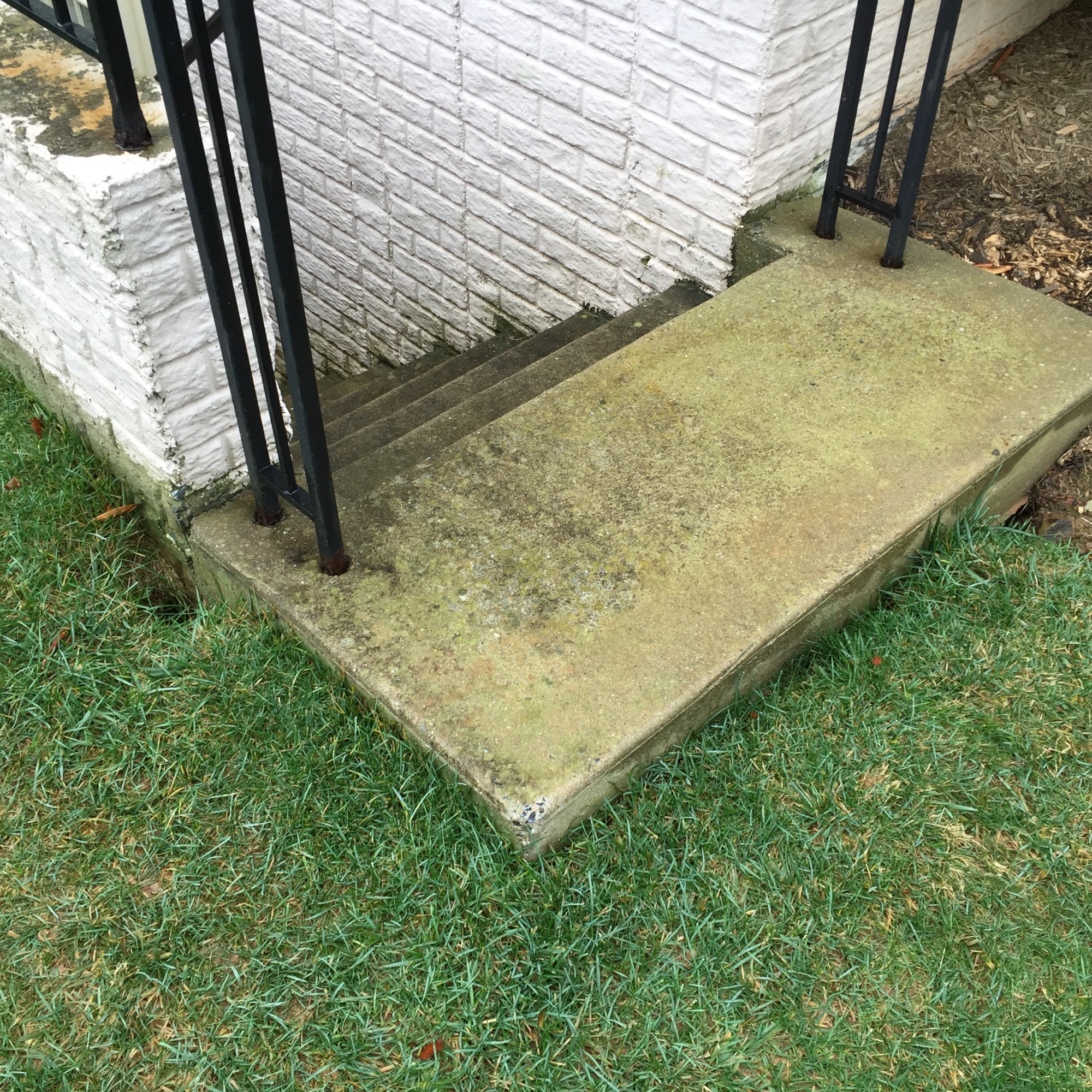

thanks much for the info, fellas. ugh, i wonder if it's a result of our crappy builder or simply the soft, clay-ey soil. in addition, the inherent drainage situation certainly doesnt help - i'm at the bottom of a street and about 5ft lower than the house next to me so i get all the run off. the yard is graded somewhat around that area but when these monsoons move through, the grading just can't deal with it. and neither can my sump drain with all that water coming down the stairs (as well as spouting through a couple small holes at the bottom of the stairs, which makes me think the void underneath is HUGE).
2 holes visible in pic, on left and right of landing.

Definitely add some soil around the top of the stairs so it slopes away. Builders rarely compact backfill properly agaist foundations as they do not want to risk causing cracks; that leads to settlement issues over the next dozen or so years. clayey soils makes it even worse if there is marine clay content, as that material shrinks/ expands; don't expect it to ever settle/ compact and be done moving. Marine clay is grey, so if you only ever see reddish clay when digging around in the yard that may not be an issue.

I bet you can back fill with pool sand then top with regular dirt. The sand will flow and fill voids and as the soil continues to compact the sand will continue to back fill. After time the sand will silt up and lock in place if there is water flow through it. Repeat as or if needed. Mud jacking is more for lifting slabs and repositioning walls.
Old 12-30-2015, 04:04 PM
'Mud jacking' is a grout injection technique that, as VG says, is mainly use to raise settled items. If you inject the grout to fill a void/ stabilize it is not mud jacking. However the contractors who do the grout injection work are generally listed as 'mud-jacking' contractors.
With the sand idea above keep adding as the sand settles (vibration will cause it to consolidate). But sand is quite porous so until/ unless it gets clogged with fines the river will still run through it
