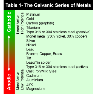

On the chemistry side, stainless (active) and aluminum are relatively close on the Galvanic Series and anodic, so it's less likely you have a galvanic interaction occurring. If the cylinder head stainless is passive, that could be an issue. Does anyone know the material specs for the cylinder heads?
If you added water, better yet saltwater, galvanic action would be a bigger issue. Here's one of the zillion charts on the web
