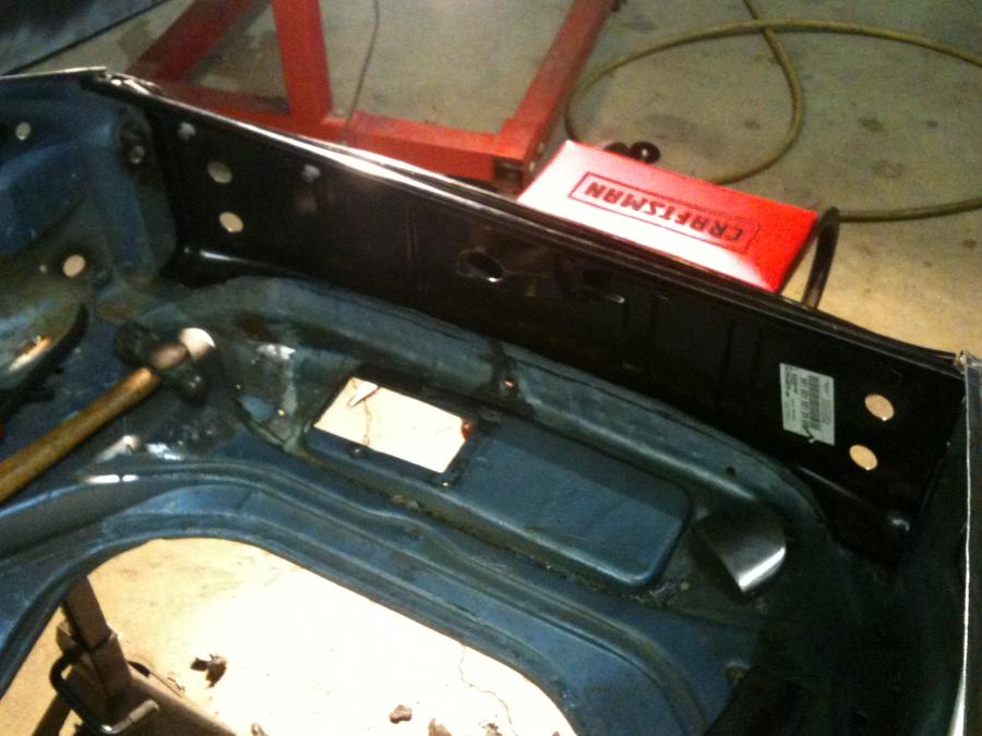

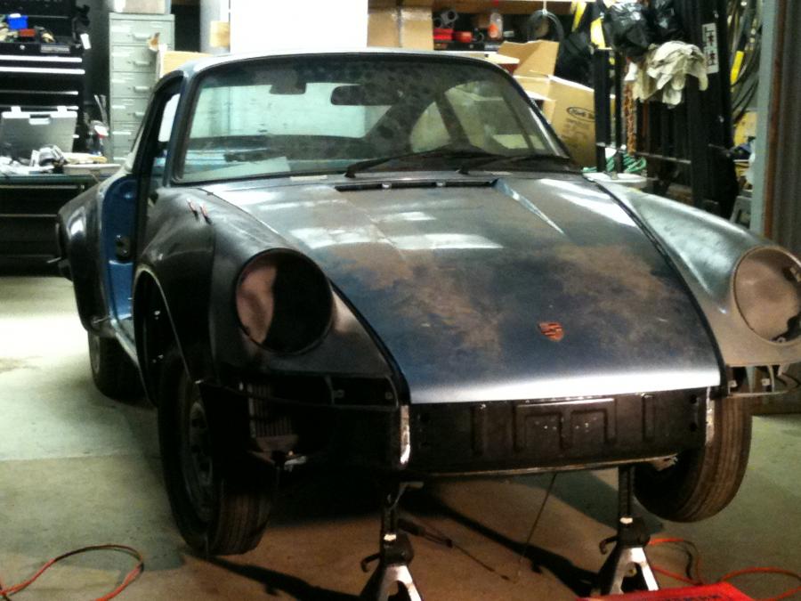

So after a long day driving to Philly to look at a truck I figured I would make it even longer and drive down to SoMD to work on the rsr.
I got the front hood latch cut out last night and mock fitted. Finished cutting out the extra metal today and got the panel in. Looks pretty good. I still have a few holes to plug from the zillion spot welds the factory felt the need to make .... Tried to make it as OEM as I could. So my rsr is officially a long hood .
Rear is finished with the exception of welding my plates to mock OEM look and filling some spots from drilling out welds with filler rod.
Slow and steady wins the race .... At least I keep telling myself that.

I forgot that the condenser panel in the trunk will also be cut out and new steel put in and the front bumper mounts will be removed for good. Also need to put in the drivers side mount for another carrera cooler in the fender for the 3.6. Having my 73 parked next to the 86 for a while before I sold it also helped with the back date. If I had any questions or needed a second look I only had to travel a few feet. Here are a few pics of the rear where the old bumper mounts were cut out ...
