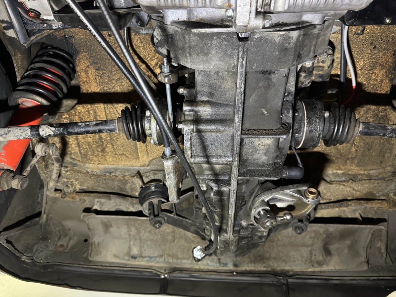

Life continues to get in the way, but I have made some progress on the 914.
Axles, clutch and speedo cables connected:
I used new bolts with new schnorr washers to attach the CVs, plus a little blue loctite. They should hopefully stay tight.
