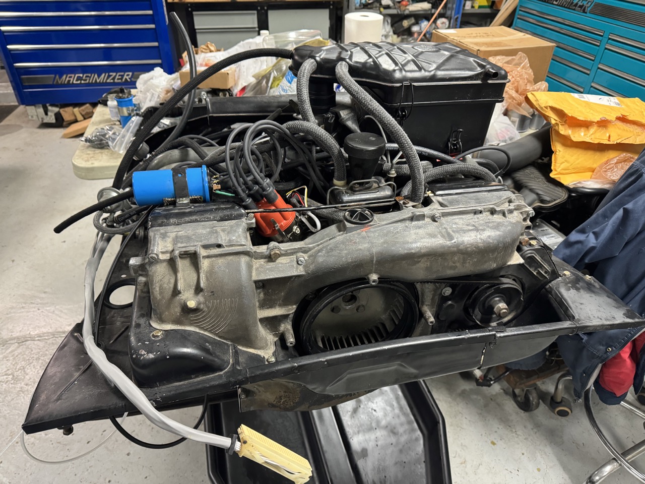

Was able to get a little more work done on the engine this weekend. Here's what I did:
  • Installed fuel rails and new fuel injectors & hoses.
  • Installed remaining wiring harnesses from @JeffBowlsby
  • Added fuel pressure gauge.
  • Installed thermostat pulley.
One hose from the AA vacuum hose kit was too short, but fortunately I had extra hose from a previous project.
Still waiting on thermostat and oil pressure relief valve, but they should arrive any moment. Once those are installed, then I need to get the engine compartment ready and I should be able to reinstall the engine.
