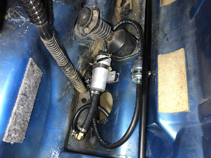

Anyway, finally got the pump, filter and hoses installed. Also ran a pair of wires from the rear to the front to power the pump. Here's what it looks like, before the tank goes in:
I ran the wires through the center tunnel, and drilled a hole in the bulkhead to connect to the pump. I fitted a grommet to protect the wires (can be seen in the above pic).

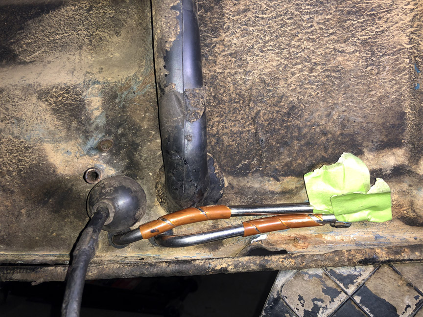

Since the snorkel tube was cracked open, I took advantage of the break to run the wires through it and up into the engine compartment.
Once the pump wires were run, I decided to fix the snorkel. If you are very careful with CA glue, the factory rubber bits glue together nicely. A tip for accurately placing the glue is to put a drop on the tip of a small screwdriver and then use the screwdriver to spread the glue. And, work in small sections, starting at the ends of the crack and work towards the center.
Almost as good as new.
