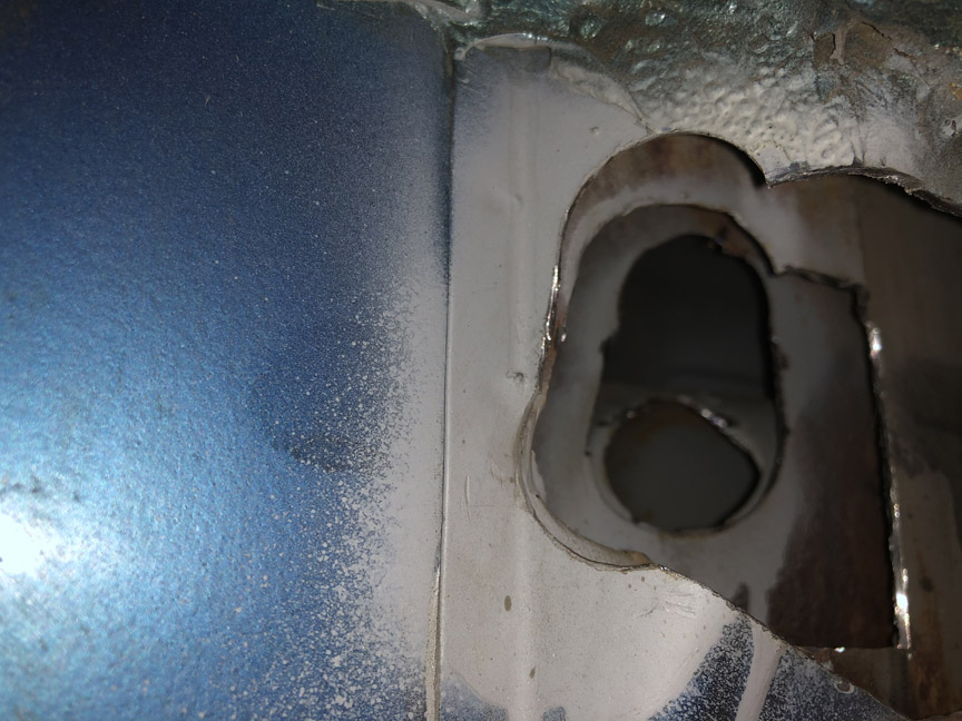

And now, let's go after this lovely bunch of holes:

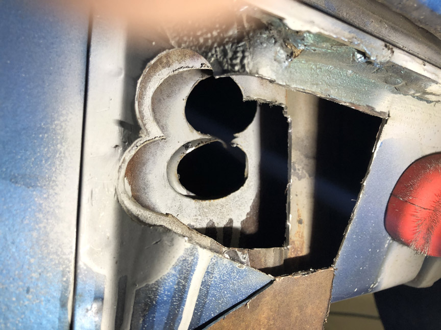

First step is to cut access holes in the outer three layers:
