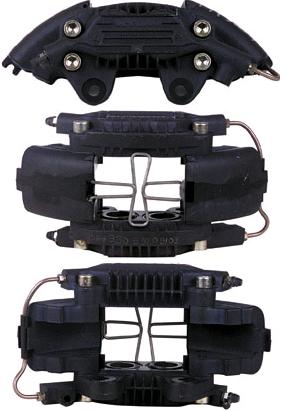

ID these calipers please!!
uhhhhh...... Please tell me what these are, I'll pee my pants if they are what I think they are.
Lucky 03-10-2005 06:32 AM
They are 930 brakes. Were you hoping for 917?
thomschoon 03-10-2005 07:33 AM
930, the picture looks like the one posted at www.autozone.com where you can order them rebuilt and with the core charge they are still only around $145 each. Only problem is that I tried ordering them a few times and they were never able to get them it, but I havent lost hope. :)
jpinkert 03-10-2005 08:53 AM
Yep, 930 brakes. So what gives? Do you have a source for them? I'm still in need of a brake upgrade for my '72. I've been holding out to see what DinFtown comes up with for 15" fuchs...

Yep...they be 930 calipers...
