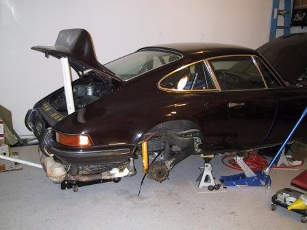

jpinkert 12-24-2004 11:42 AM
Happy Holidays Dorki Style
Had some fun in the garage yesterday -- which will continue throughout the weekend.
VaSteve 12-24-2004 11:43 AM
Dorki-style usually involves a dozen people and 3 dozen donuts. :D
Jazzbass 12-24-2004 12:36 PM
And beer.
Mackpipes 12-24-2004 12:40 PM
That looks way too safe to be Dorki style. Where are the wood blocks? :P
jpinkert 12-24-2004 12:48 PM
Too cheap to buy donuts or beer. And there are wooden blocks if you look carefully -- between the jack stand and the car.
Now if I could only figure out how to get the new trailing arms into the car. Then I'll put the motor back in. The monoballs are just a few mm too wide to fit into the trailing arm mounts.
Jim Richards 12-24-2004 01:38 PM
I think any advice will require donuts and beer, Josh. Don't you other guys concur? :D
Josh, what's the snag you're running into? The new trailing arms should go in the way the old ones came out. Or are they a different size (e.g. 930 trailing arms)?
jpinkert 12-24-2004 04:43 PM
The new trailing arms are carrera aluminum arms. But I've also installed monoballs, which are too wide to fit into the trailing arm brackets. My guess is that the trailing arm brackets have been pinched a little over time due to tightened bolts against rubber bushings. So I made a trip to Home Depot to get enough material to build a small press. It should do the trick...I'm waiting for my little heater to work some magic in the garage.
Wish me luck! Beers are in short supply around here. Only 3...er...2 left.
