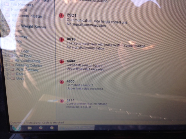

Any chance the codes were camshaft sensors that I've been getting? It put me in limp mode a couple of times.
Attachment 44095

4403 looks familiar. I believe that's what I had. In your case, I'm not sure if 4903 refers to a second sensor on bank 1 or just bank 2. We're talking 986 vs 987.2. When you get a chance, connect your Durametric and at idle go to the "actual values" menu and look at the camshaft deviation on both banks.
