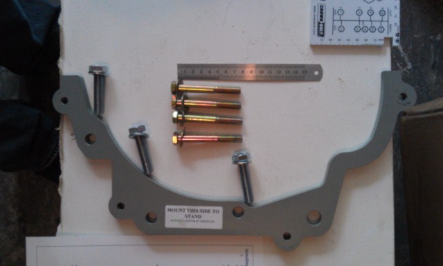

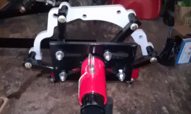

I wound up getting the one from Mainely to use on a regular inexpensive engine stand. Well made, cheaper, and easier to store. Here's some pictures:
Attachment 40728
Attachment 40729
Attachment 40730

I have one of those too. Works better if you use longer bolts and some pipe to make room for clutch and flywheel.
BTW if you haven't gotten a stand yet look around for one that's tall enough to allow 360' rotation of engine w/heads. You'll be much happier in the long run and the work will proceed smother too.
