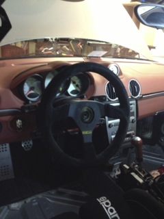

I'm lightening up the Cayman and preparing to have Piper install a roll cage. Here's some pics.
Attachment 36016Attachment 36017Attachment 36020
Attachment 36018Attachment 36019
Now working on the doors. Ryan's article and a quick peek at his car today helped me figure out some things. I'll post updates as I make progress.
Attachment 36021Attachment 36022
