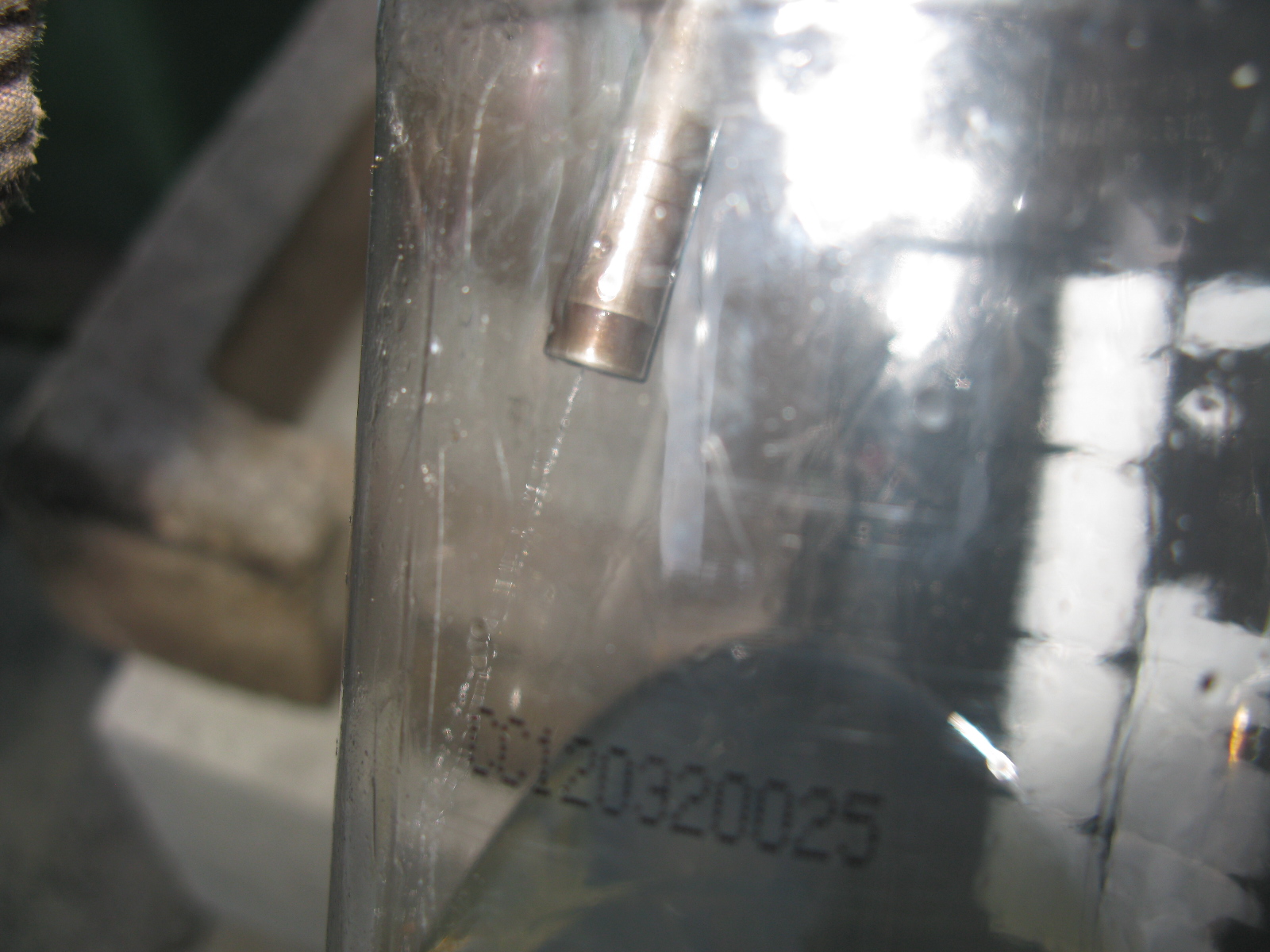

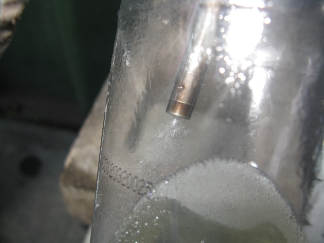

While waiting for my left-handed drill bits to remove the broken pilot bearing bolt, I started cleaning the '82 911SC's fuel injectors. I am getting the same spray pattern results on cylinders 1 and 3, than on #2. I am wondering if there is problem with #1 and #3. I am also wondering if I must replace the cracked cylinder 1 injector sleeve (picture attached). I looked in Bentley's and it isn't clear how how I would remove the sleeve.
Here is the data: #2 sometimes has a very slight drip around 46 psi, and then begins a beautiful spray pattern around 51 psi. The pattern remains good, even if I raise the psi to over 60psi.
On #1 and #3 - even after cleaning have the following results:
A) No drip even after 45 psi
B) Around 49-50psi - it begins a single stream "piss" of fluid
C) Around 52 psi - I get a good spray pattern
D) Around 60 psi - the pattern changes and blasts fluid out
I like the way that #2 behaves - should I expect that for all of the injectors? The injectors only have around 30K miles on them. I replaced all of them around 2002.

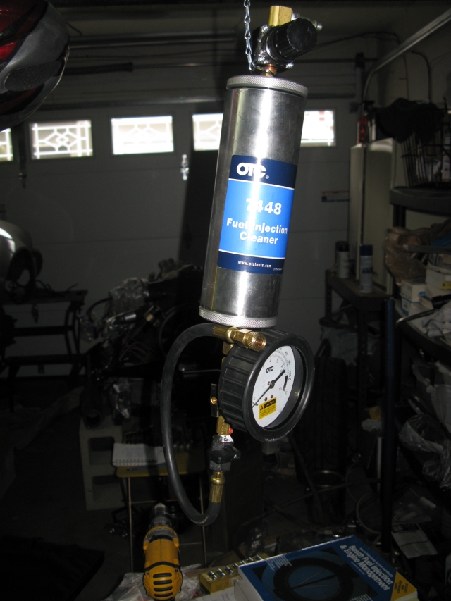

Here is a description of my set-up
I bought an OTC fuel injector cleaner on Amazon, and used the CIS compression fittings from the fuel pressure kit I bought on eBay. I have a brew of 50% SeaFoam and 50% gas.
I use the Bosch fuel injection steps for testing & cleaning - check for any leaks at 22psi.
Slowly raise the psi to see and record when the injector 1st opens
Add a few more psi to see when I get a nice spray pattern
Clean the injector by sending bursts of pressure through the injector
Lower psi until injector closes and then raise the psi to 7psi below the measured opening psi to see if there is a leak. (So far none of the 3 I have tested have leaked.)
Pictures of the set-up; the spray & the cracked port are attached.
