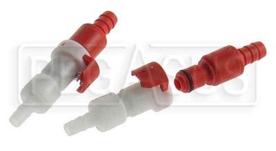

If you're buying connectors anyway... Get one pair of the red fia mandated ones that will pull free if tugged on hard enough.
http://www.pegasusautoracing.com/pro...asp?RecID=5271

Ew.. $54 or $9.. Hard call. ;) I guess if you are racing FIA, you may want to start off by getting those. But what a crock.. Wouldn't mind paying a little more, but 500% is ridiculous.
They can be found for less elsewhere but are still more expensive.
