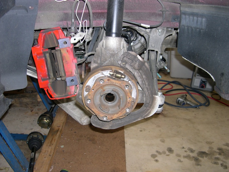

Step 2 - after jacking up the car and removing the axel, you can begin disassembly of the brakes. Take of the caliper with the 2 10mm Allen bolts and remove the 10mm bolt holding the brake line to the back of the hub carrier. Hang the caliper to prevent damage to the brake line.
Attachment 22021

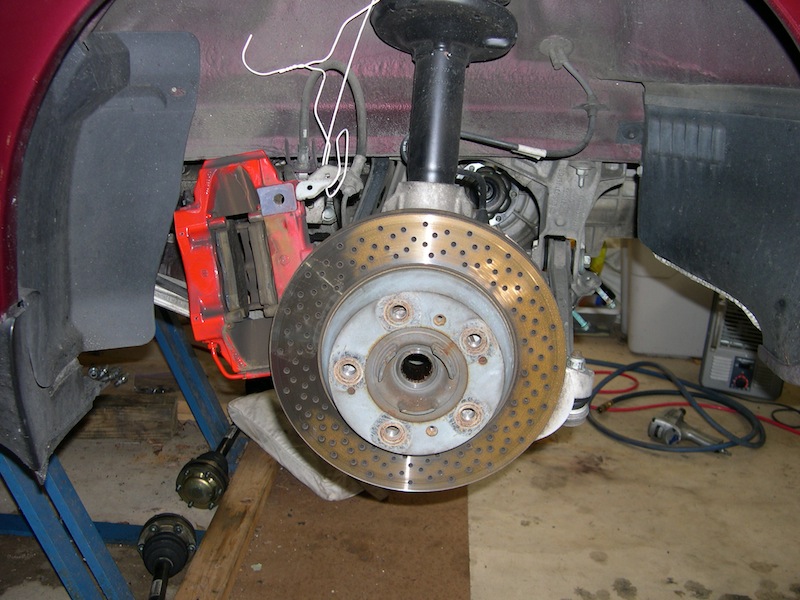

Step 3 - remove the brake rotor.
Attachment 22022

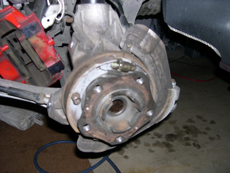

Step 4 - remove the parking brake shoes.
Attachment 22023

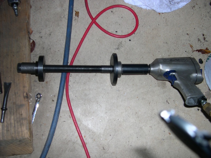

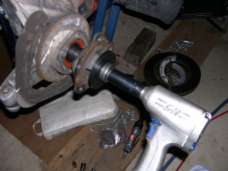

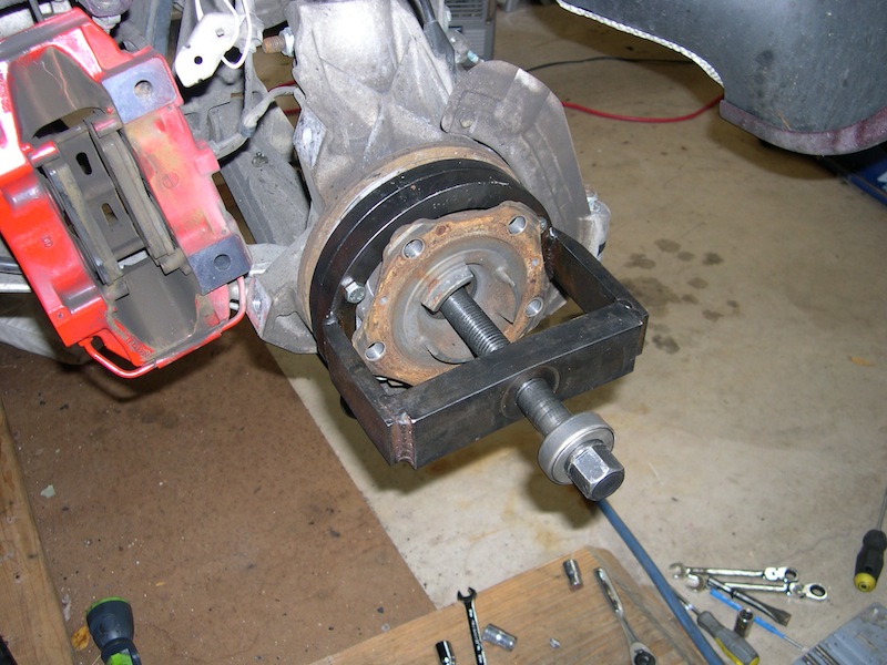

Step 5 - Now use the SIR kit to pull the hub out of the bearing -- note the outer race will come out with the hub.
Attachment 22024
Attachment 22026

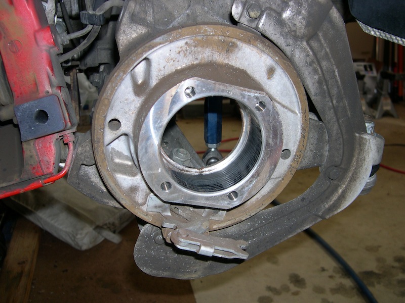

Step 6 - Remove the 4 13mm bolts holding the bearing retainer to the hub carrier.
Attachment 22025

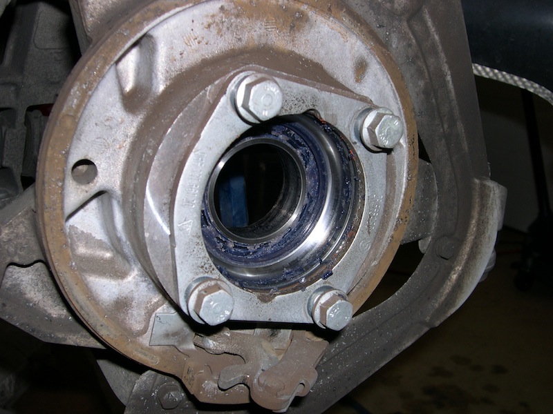

Step 7 - Use the SIR kit again (with the proper size "puck") to pull the bearing out of the hub carrier.
Attachment 22027

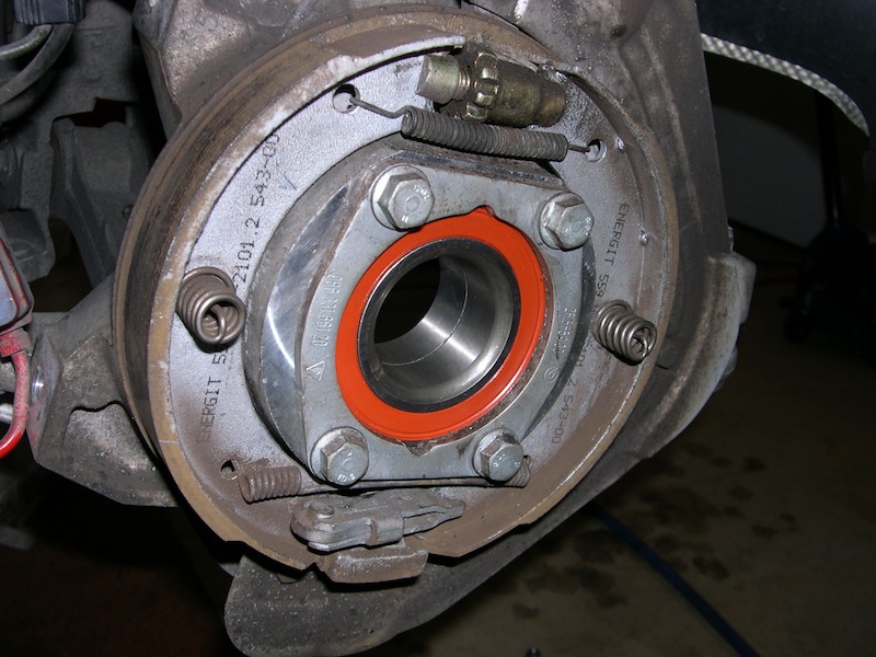

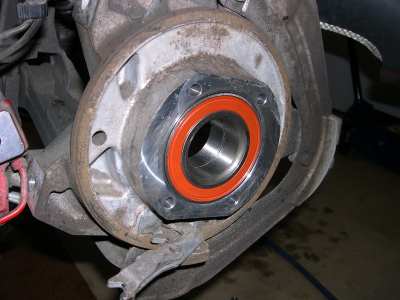

Step 8 - Using just the threaded rod and properly sized pucks from the SIR kit, push the new bearing into the carrier. One puck goes on the inner side of the hub carrier while the other sits flush on the outer race of the new bearing. Install the new bearing with markings facing out.
Attachment 22028
Attachment 22029
Step 9 - reinstall the bearing retainer and parking brake shoes.
Attachment 22030

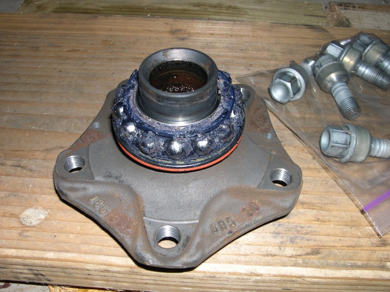

Next up is removal of the outer race from the hub and then use of the SIR tool to push the hub into the new bearing.
I was able to remove the race from the hub by heating the race with a propane torch and using a hammer and drift to get about 1/4" of clearance. Once I had enough clearance I used a three arm puller and a slide hammer to yank the race the rest of the way off the hub.

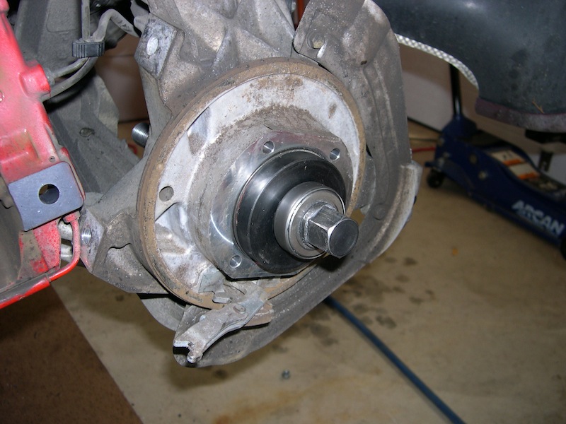

Step 1 -- select the proper "pucks" for reinstalling the hubs. The outer puck should be large enough to rest on the 3 wheel centering prongs that stick out from the face of the hub. The inner puck will sit on the inner race of the wheel bearing -- this way the bearing is squeezed together while the hub is pushed into it.
Attachment 22053
Step 2 -- once you have the proper set up, use the SIR kit to push the hub into the bearing.
Attachment 22054
Step 3 -- check your work. The hub should turn smoothly with no binding or play. If you feel movement when you push the hub in or pull it out, then the inside race didn't get pushed fully onto the hub.
Attachment 22055

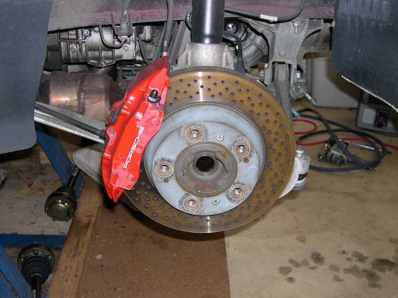

If everything checks out, you are now ready to reinstall the rotor and caliper. Put some blue loctite on the two small phillips screws that hold the rotor in place. Also make sure you put a liberal amount of anti-sieze on the caliper bolts to avoid a future issue due to corrosion. Some suggest using new caliper bolts, you make the call.
