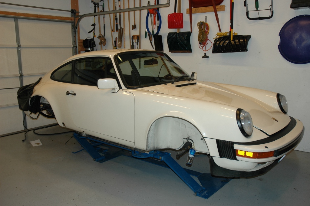

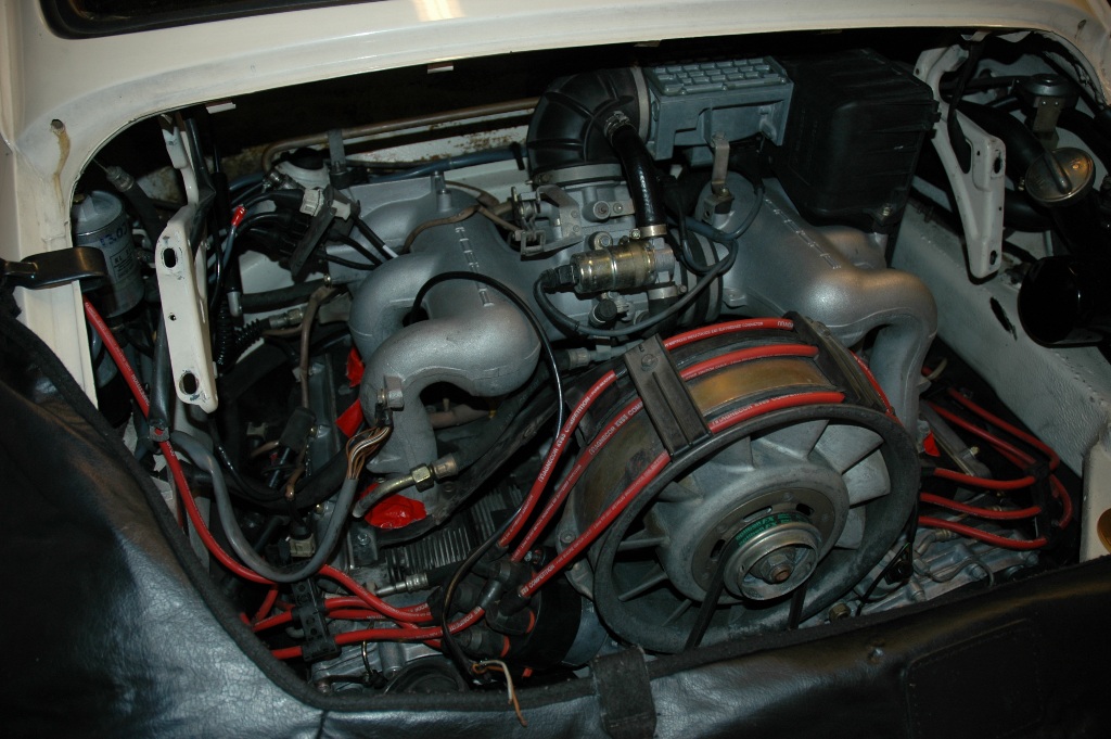

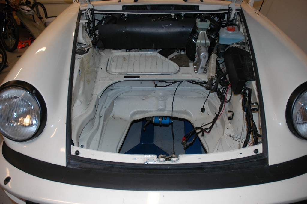

So, one thing has led to another, and as a result, here is my car right now:
Attachment 5269
Attachment 5271
Attachment 5270
VaSteve 05-30-2007 11:03 PM
LOL, I seem to be having flashbacks to 2004 when you did the suspension in the middle of track season!
rs911t 05-30-2007 11:07 PM
I agree with assessment #3 .... may The Force be with you. ;)

Fuel System: Fuel tank is out, and I'm debating on getting it cleaned. You know, WYIT :D. All new fuel lines are ordered, but they are out of stock in the US and have to come from the Fatherland - probably be here next week. Yesterday I pulled the injectors and today took them to Ivan at IMA for cleaning/rebuilding/flowing. I read a post on Pelican about a local guy (Dorki?) getting the main engine fuel line redone at a hydraulic shop in Baltimore - I'll probably check them out later.

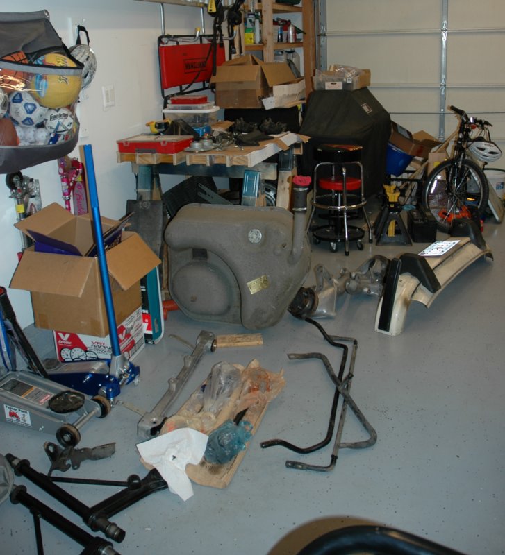

BTW, here a pic of the OTHER side of the garage. It's amazing how many little pieces there are to a 911 when you take them all off at once:
Attachment 5272
BlackTalon 05-31-2007 12:22 AM
Damn, you are really hitting it hard! Guess my damn Targa's gonna be lagging behind everyone again :-( :-)
Dr K 05-31-2007 02:19 AM
I hope everyone else notices how CLEAN your car is, even the wheel wells. It looks even cleaner in person. I want to borrow your daughter to clean out my wheel wells, Chris. Oops, too late, suspension going back on, so at least one of us can go to SP in a week and 3 days.
KevinOyler 05-31-2007 06:38 AM
Very ambitious, and looking nice. Now, wyit, if you could just address those bumper bellows.
