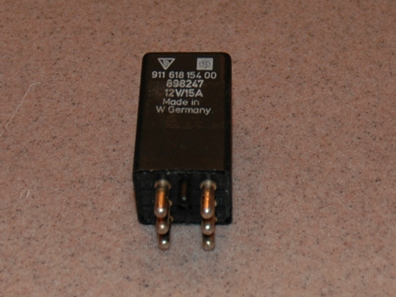

Here's a pic of the DME relay that was in my car when I bought it:

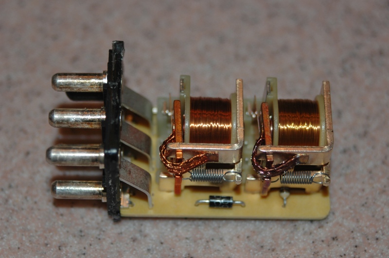

Inside - showing the relay side. You can see the two relays - the one on the left is the fuel pump relay and the one on the right is the main DME/fuel injector relay.

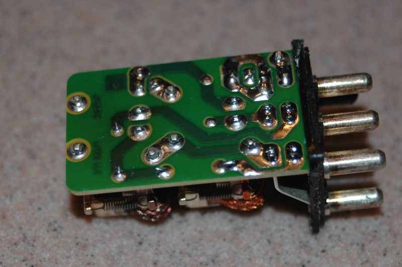

The other side showing the PCB that the relays are soldered to. This is typically where the problems occur.
Attachment 3769

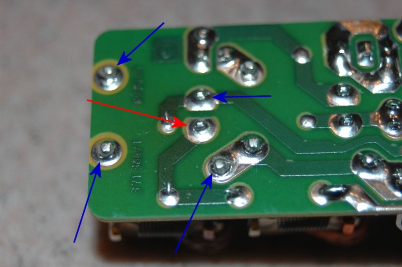

A quick inspection shows that sure enough there is one solder joint that has failed (red arrows) and several I'm not too happy about (blue arrows). Note the solder joint that has failed has a ring around the pin - this is a crack in the solder joint. Cracks are caused by vibration of the component (the relays are heavy and then to crack their solder joints quicker than smaller components) and heat/cool cycles expanding and contracting the solder.
Attachment 3770

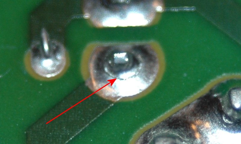

Here's a close up of the bad solder joint, with the red arrow pointing to the crack.
Attachment 3774

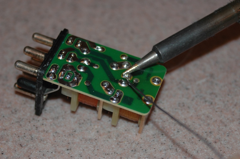

Fortunately, its an easy problem to fix with a soldering iron. Here I'm reflowing the solder on all the joints. When I do this I add a little bit of new solder, but not too much. The main idea is to completely melt the existing joint. When it cools, all the cracks will be gone. NOTE: Don't blow on the solder to cool it! This can cause the solder to cool too fast and you get what's called a "cold solder" - a joint where the solder doesn;t adhere properly to either the component, the board or both.
Attachment 3771

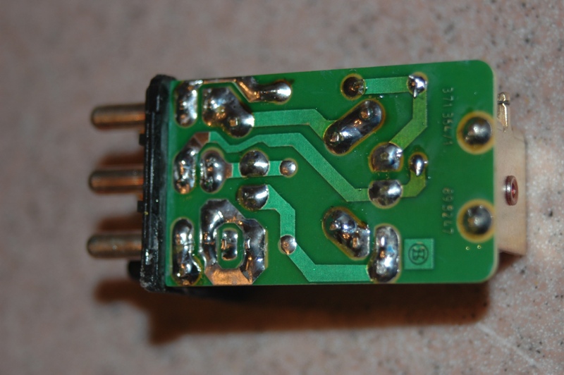

All the joints reflowed. Note the excess flux on the board. I could wash this off, but I'm lazy and don't feel like it. Not a big deal anyway.
Attachment 3772
There you go - DME relay repair made easy!
