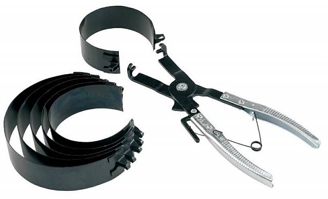

120 degrees is pretty standard for a 3 ring setup.
I found this type of ring compressor works well
Attachment 44201
It lets you see more of what's going on.
Most order at least one (but 2 is better) extra ring sets! Listen carefully and if you hear a small "ting", start over. Cause you just broke a ring. Saw a car show over the weekend where a guy was putting rings on a Hemi piston, and it sure is easier on a big bore piston!!!
