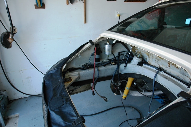

Charlie was over yesterday and he finished the rear suspension and brakes. The rear of the car is pretty much done and ready for the engine to be reinstalled (planned for tomorrow night). I have to tidy some wiring up in the engine compartment today, but that's about it. BTW, I found you could remove the whole rear fuse box when you backdate your heat and loose the rear window defroster:

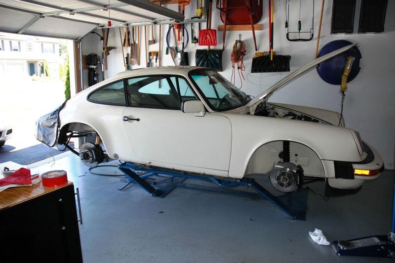

So here's the car right now:
Attachment 6060
The front of the car is coming back together. I finally made a new brake line to the passenger front wheel after kinking the old one in an attempt to get more clearance for the steering rack. I put new front bearing in the hubs yesterday, and the bearing retainers and the 4mm VCI spacers on the new spindles are on. I was pleased to see that even with the 4mm spacer, the bearings are still fully seated on the spindle and the retaining nut is fully threaded. If either of these didn't work out, I would have bagged the VCI idea.

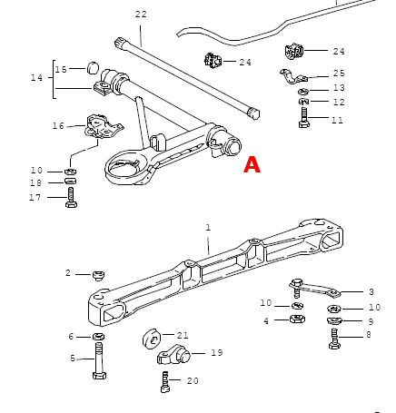

When we got to the front suspension, things started getting a little more difficult. First issue came in installing the a-arms w/ the ER poly-bronze bushings. I got these bushing in 2004 so it's not a new install, but when I first put them in they were still a pretty new product and there wasn't a lot of knowledge on how to install. Turns out I did a couple things wrong the first time. First was to try to get the steel races as tight as possible on the a-arm by using 1/2 or 1/4 of a shim. What I found out later, this can put the race out of round, making it bind somewhat. When I pulled the a-arms out, both rear races had come loose, so I decided to use a new technique }{ picked up from PPBBS - getting the races close on the a-arms with full shims, and using Loctite to set them in place. In my case, instead of red Loctite, I used Sleeve & Bearing retainer, which worked very well. Once it set up, the races were on there but good.
The second mistake I made was just bolting everything together without checking to see if the a-arm could swing without binding. When we bolted stuff up, both sides bound. Charlie was able to fix the driver's side by simply unbolting and re-torquing the bolts a few times. My side (passenger's) was a much bigger PITA.
Attachment 6064
As it turns out, when the main crossmember bolt (5) was tightened, it was squeezing the aluminum crossmember (1), and thus squeezing the rear bushing housing and bushing (A) . When the bushing was squeezed, the a-arm (14) bound up. It took a while to figure this out, but Charlie called it correctly. We pulled the a-arm and found that bushing housing (A) was very difficult to get out of the crossmember. That was part of the problem - if the housing is binding going into the crossmember, it's going to get pinched when the mounting bolt is torqued. There was some corrosion build up where the bushing meets the crossmember, which I got out with a dremel. I had POR'd the bushing housings, which was part of the problem, too, since POR is actually quite thick. The dremel took care of that, too. In the end it still wasn't enough, as it still bound when tightened (although not a much). A very thin spacer between the crossmember and the bushing housing where the mounting bolt goes through was the answer - it prevented the crossmember from squeezing the bushing housing too much. Now, the a-arms on both sides swing freely and with very little friction.

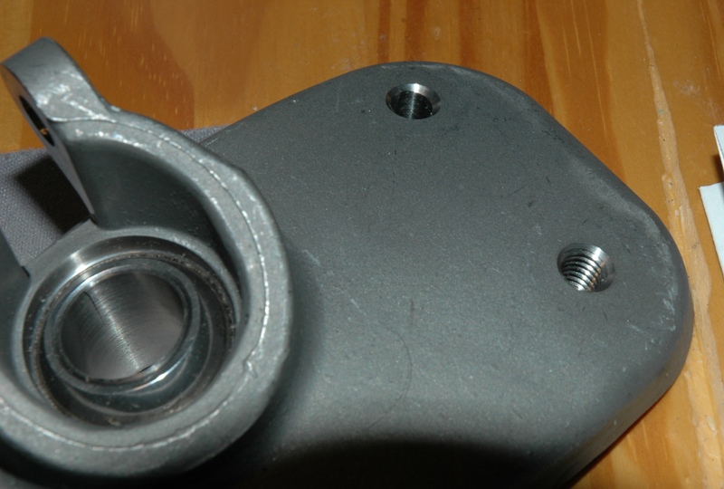

If you said "the hole isn't tapped!" step up and claim your Rice-a-roni gift basket. WTF? This isn't cheap-ass made in China for $10 stuff, this is a $600 strut brace/monoball setup from Wevo. Well, fortunately I have a tap and die sets and Charlie and I were able to tap the hole. But seriously, what a PITA. For what that thing cost, I shouldn't have to spend 1/2 hour making my own threads (it was a bitch to tap, BTW).
