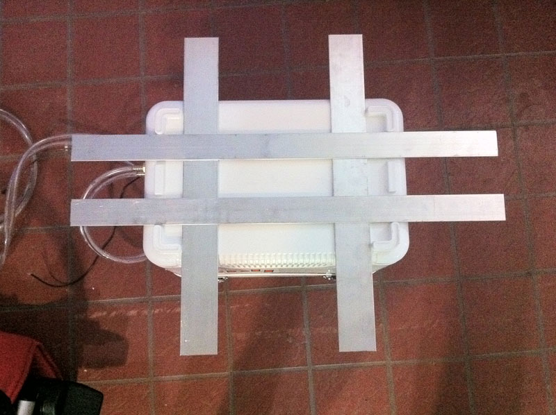

So I figured a base was in order to keep the cooler from skulling me in the middle of turn one. Here's what I came up with.
I bought some aluminum flat stock from Home Depot. It's inexpensive and came in all sorts of lenghts and widths. I got 4 feet of the 1 1/2 by 1/8 stock and 3 feet of the 2 by 1/8 stock. It was easy enough to cut with a hacksaw.
Here it is laid across the base of the cooler.

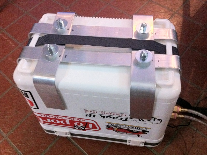

To bend it, I used a propane torch, a C clamp, and some scraps of plywood and a pair of vice grips. It made a decent impromptu press break. I had to heat the aluminum for about 30 seconds to make it reasonable to bend.
http://dorkiphus.net/porsche/attachm...chmentid=27596
Then I drilled a few holes and bound it all together.

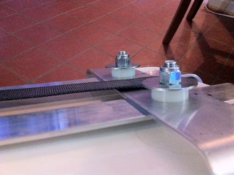

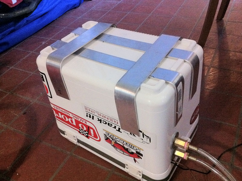

And here is a close up of the base. As you can see, I'm taking advantage of the strap provided with the cooler to lash it too the base securely. The spacer will give enough rise to get over the uneven floorboards. The flat washers should keep it from pulling through the thin sheet metal.
http://dorkiphus.net/porsche/attachm...chmentid=27598
I think it should pass tech without concern and can be removed quickly with 4 bolts if it interferes with the passenger. What do you think?
